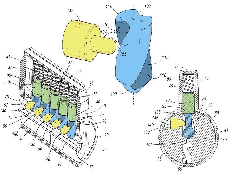

I ran across a new patent application today from Schlage (2009/0282881), that includes an interesting approach to making an anti-bumping pin. They're proposing to mill a spiral groove into the bottom pins, and have a second pin in a side chamber that protrudes into that groove:
The side pin doesn't actually participate in locking the cylinder: it's simply there to force the bottom pin to twist as it lifts -- the idea being that you can't rapidly bounce it up with a pick-gun or bump-key. (The tips of the bottom pins aren't chiseled, so the "twist and lift" approach is just there as an anti-bump feature, rather than being a way to interact with a sidebar, like in a Medeco.)
Interesting idea.

Neat idea... one thing though, the key pins would need a bit more energy to move because of how they twist so wouldn't this actually make it easier to bump open? What I'm thinking is that the energy would be transferred to the drivers more effectively, since the key pins need more energy to move... ie. the drivers jump faster than the key pins, making the shear line even bigger.
That's assuming these pins are present in all chambers anyway... as for having just a couple, I think that'd basically just be the equivalent of bumping a cylinder with hi-lo pin stacks, which is harder, but definately not impossible.
Correct me if I'm wrong here cos my physics isn't always the best :mrgreen:

I wonder whether having a cylinder filled with these twisting pins might make the key difficult to insert and withdraw from the cylinder? I am aware it works doesn't impede the process when used in Medeco locks, however Medeco cylinders don't have a 'screw' action for the pins to undergo.
Suspect 3 pins per lock will be like this in implementation to counter this, if this is the case. :)

I agree with Solomon... I feel that these twisting bottom pins would not be an efficient deterrent for bumping. Remember that the theory of bumping is that the bottom pins actually don't move very much, if at all. I also see the potential for attacks similar to the Michaud attack (http://www.crypto.com/photos/misc/mul-t-lock/) or simplified Falle-style shim decoding.

use groove to probe pin size?.......thin wire + modified sc1 blank and i think(if they use them in all their cylinders) we could rapidly decode these very easily.

This is indeed an interesting find. Did the patent info state specifically that it was for bump prevention? I wonder if bumping would still be just as easy. With the top pin in contact with the bottom pin, the impact on the bottom pin would be likely to create a separation. It might make the separation between top and bottom pins even more because the bottom pin would be less likely to have moved much. The comparative example of two billiard balls touching when the cue ball strikes them comes to mind. The first ball remains stationery and transmits all the kinetic energy to the second ball which then moves away with almost the same velocity as the cue ball.
If this concept had a sidebar and the spiral groove had a valley or hole for the sidebar pin to fit into it would be pretty difficult to pick.

Raymond wrote:Did the patent info state specifically that it was for bump prevention?
I'm viewing it with the same degree of skepticism as everyone else, but that is their claim:
    In a conventional lock, relatively quick movement of the inner pins could be caused by bumping the inner pins with an improper or inappropriate key (not shown) in an attempt to pick the lock. In [this] lock cylinder, the [side pins] limit or resist movement of the inner pins [vertically] when the inner pins are bumped. [...] As a result, relatively quick movement of the inner pin is inhibited, [and] the outer pin remains partially disposed in the inner pin chamber, and the plug cannot be rotated to the unlocked position.
I agree with the point about the pool balls, but I think what they're trying to do is to limit the amount of force the bump-key can apply to the drivers, by making the bottom pins harder to raise. I'm in need of a coffee at the moment -- so I may not be quite thinking of this correctly -- but I think the "pool ball" analogy works better with a pick-gun than with a bump-key. A bump-key works by sliding its tiny "teeth" underneath the bottom pins, in order to quickly raise and drop them. If you can't quickly raise the bottom pins, then (I think?) the bump-key's teeth are going to "catch" on the bottom pins, and far more of the bump hammer's energy will be directed back (i.e., in the direction that the key's moving), rather than upwards and into the drivers? (This differs from a pick-gun, which isn't trying to translate the "horizontal" motion into a "vertical" one.)
Either way, I like mcm757207's suggestion of a Michaud-like attack, if the grooves actually run right down to the bottom of the pin (which they do in the patent diagrams). Nice idea!
