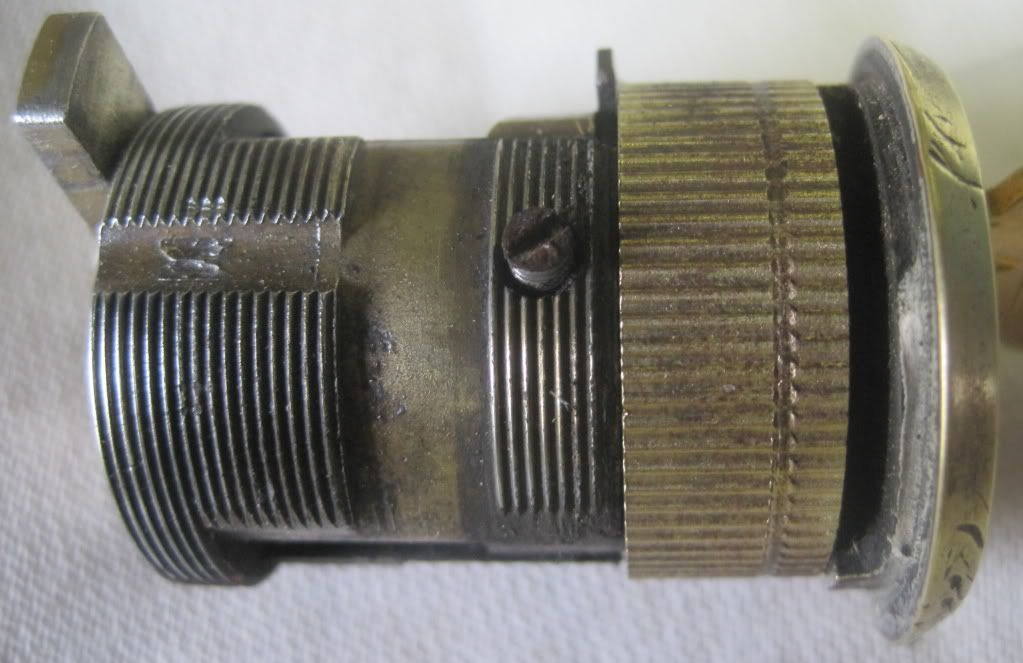

I have obtained an old Yale mortise lock and cylinder, the cylinder is adjustable. I have picked it but have tried to dis-assemble it in order to re-key to no avail. I'm certain that someone here has that knowledge and will share with me with this issue. Appears that a knowledgeable Locksmith has prepared this cylinder due to the marking and arrows stamped on the cam end. Pic's uploaded.

If it is like the Russwin adjustable cylinder you remove a screw, the same one that extends the body until the threaded portion comes off, then rekey it the normal way.

Even without seeing it I will venture a guess on how to take it apart. Unscrew the adjustment screw all the way. The threaded shell will then pull off of the actual cylinder. The retainer on back of the plug will now be exposed for rekeying.

I tried to un-screw the adjustment ring all the way, but it came to a dead stop and would not budge and the ring does move very easily until it stops in both directions. I'd like to know what the arrows are for, maybe alignment for the dis-assembly?

from your pictures it doesn't look as if the cam comes off. the screw heads weren't visible, and it looks as if the tail of the cylinder was peened over. i would make sure the collar (ring) was loose, and then turn the plug until the arrows lined up. it looks as if it might be some type of 'bayonet' fitting where the rear end of the cylinder would pull off when the arrows were aligned.

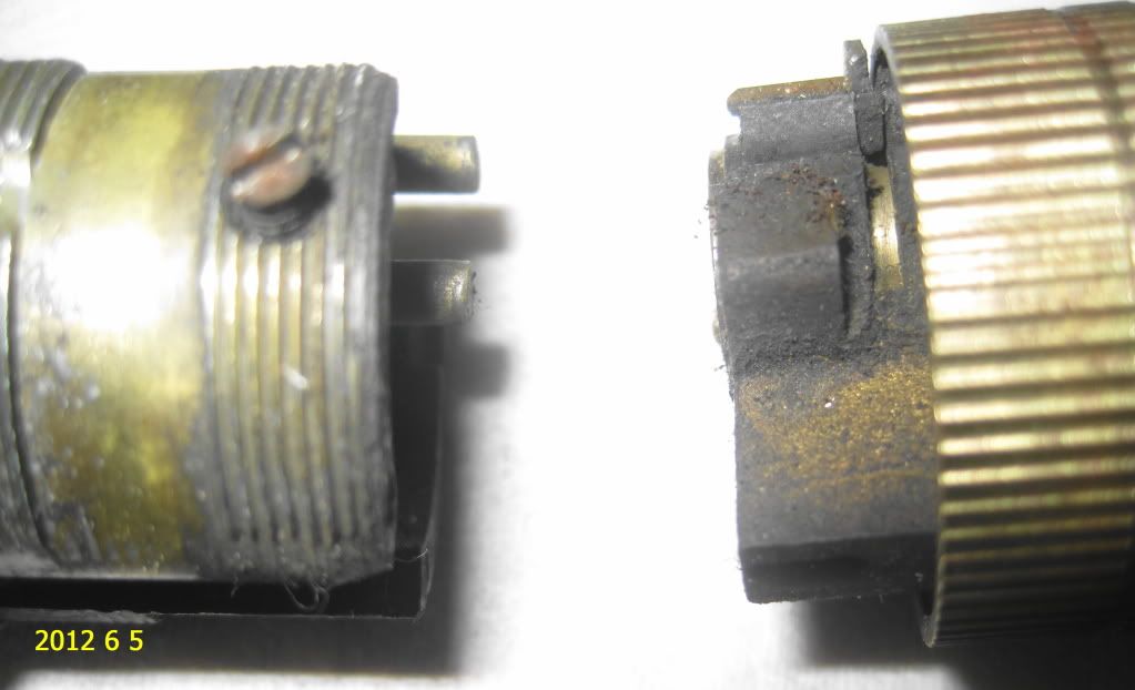

Thanks for the info Gibson, in the 3rd pic there appears to be a pin maybe and looks almost like a flathead screw slot in it. I'm wondering if it was pressed in.

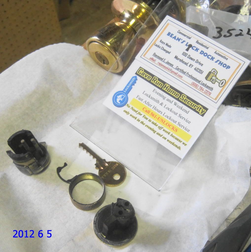

I finally found it!(Eureka) The knurled ring did turn more and revealed a hidden screw that let me continue to turn until the cylinder came apart.
Thanks to all that shared with me to complete the task.

Now that we've accomplished this task, I'm going to use my Framon #2 to generate a key by using the Original Key bittings from the pins to keep the lock and cylinder as Authentic as possible.
