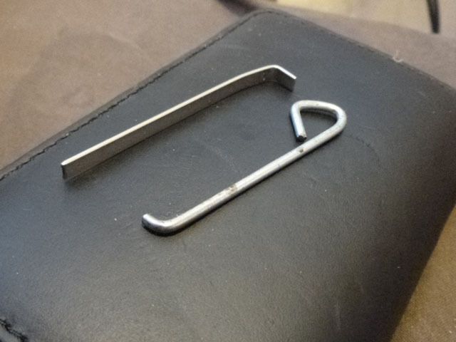

Hi pals.. just wondering if anyone has an idea regarding this Haliba Top Security 70 mm padlock? this is just my first encounter of this kind..and after studying the possibilities..how to defeat it and fabricating the possible picktool, luckily i was able to picked it open. it was not as tough as i thought actually. now i want to take out this core..minimizing errors on locating the retaining pin. that holds this core. now the question.. DOES ANYONE HAS ANY IDEA OF THE RETAINING PIN LOCATION? Here is the pictures.. http://i302.photobucket.com/albums/nn11 ... pdlock.jpg

and to my fellow locksmiths: (who has no knowledge of it yet.. in picking this lock)
the technique is quite similar with picking abloy padlocks, but just a lot easier than Abloy.
the pick tool and tension wrench i showned here, you can fabricate that by using an ordinary flat key, and the tension wrench is what i called "the praying mantis wrench"
regards.
http://i302.photobucket.com/albums/nn11 ... memade.jpg

The circular bit "guarding" the keyway is held in by a retaining clip and it can simply be prised open. I only learned this myself very recently; never tried to take one apart before and never had to DE one. The chinese ones are a 2 minute pick at an absolute maximum... many will open in under 30 seconds. The picks I made are much simpler; you can see them here. It isn't necessary for the tip to have the "T" shape although with a basic "L" it does seem to matter which direction it's facing. One way you'll get crisp feedback, the other way you feel nothing. Kinda weird.
I see this thread being moved to advanced very soon... or are we allowed to talk about picking these now? I know they're the same mechanism as abloy, but it's kinda like comparing a kwikset with only 4 pins in it to an ASSA in my opinion. I can fly through these but I'd never pick an abloy to save my life. Even the semi-cheap-but-not-too-cheap ones like solex, monterey and kräll will give you a run for your money.
