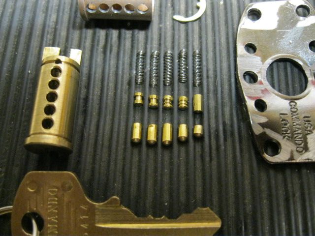

recently i acquired a nice new commando padlock. After working with it for a bit i was able rake and then SPP this nice laminated padlock. Overall i would say its a pretty good lock, much better than a Master for sure. After picking my way around it for awhile i realized that i really wanted to see the guts of this lock and since i wasnt able to locate anyone elses autopsy photos i decided that it was up to me. After cringing at the thought of tearing into a really nice, brand new lock, i bit the bullet for your viewing pleasure.

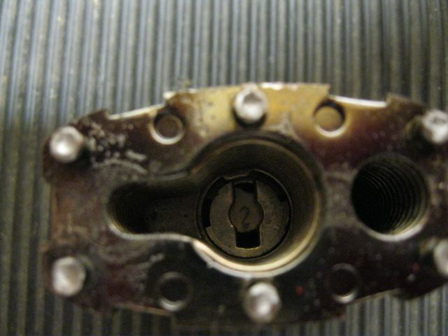

I was pleasantly surprised to discover that it wasnt a simple matter of grinding off the protruding rivets and popping off the plates. Once i had the 6 rivets off and i tried to do some prying i realized two things, the rivets were countersunk into the bottom plate requiring me to go deeper than expected. The second surprise was that it appears as if every plate is also connected by a pattern of four embossed divots (will require more disassembly to confirm this). This was not an easy lock to peel, the rivet pins were reasonably hard and the plates were quite flexible, this combined to make it very difficult to remove the two plates to get to the cylinder.

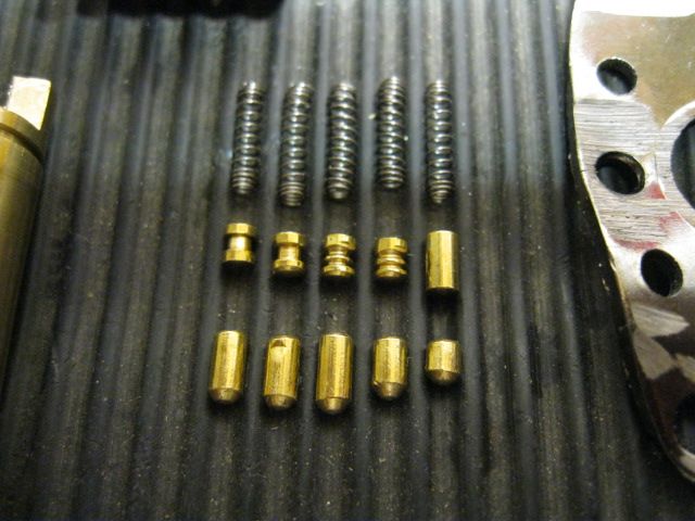

Below you will see the security pins infesting this lock. Im pretty happy about this personally as ive really been struggling with spools for awhile now and i have opened up this lock quite a few times. Chalk that up to personal victory-yay!
I was hoping to be the one to discover some glaring flaw, like a simple bypass technique a la the american bypass tool. Well, thats not going to work with this lock. The tailpiece fits snugly into the cam (?) that lets the ball bearings do their thing- the lock is open when the plug is turned and thats the only time.
and finally, the commando lock bares all:
in the next pic you can see the four press fit embossed divots i mentioned, they are in a square pattern around where the lock goes (in the blurry part).

Interesting pins in there :P

Thanks for the pics. Those are pretty cool driver pins. It looks like the first spool has flat edges, the second has beveled edges, and the third and fourth are double spools, with the final driver being normal. Nice variety, with different feedback likely with most pins. I also see the spring wire is heavier in some pin stacks than others. Definitely going to be a challenge to pick this baby.
Thanks to your picture and description, now I know what Commando Lock means by interlocking laminated layers. Interference fit on those four tabs? This looks to be an outstanding piece of workmanship.
Question: Once you had the two lamination layers off, did the cylinder just fall out easily, or was it interference fit, too?

ah, interference fit! i knew there was a better term for that than i used, thanks! After i removed the two bottom plates the lock came right out. It was very difficult to take this padlock to the grinder, but in the end i couldnt help myself. I think im going to remove all the pins (that hold the lock together) and replace them with nuts and bolts, flatten the bent plates i removed and reassemble the lock. Im glad you guys enjoyed the pics.
