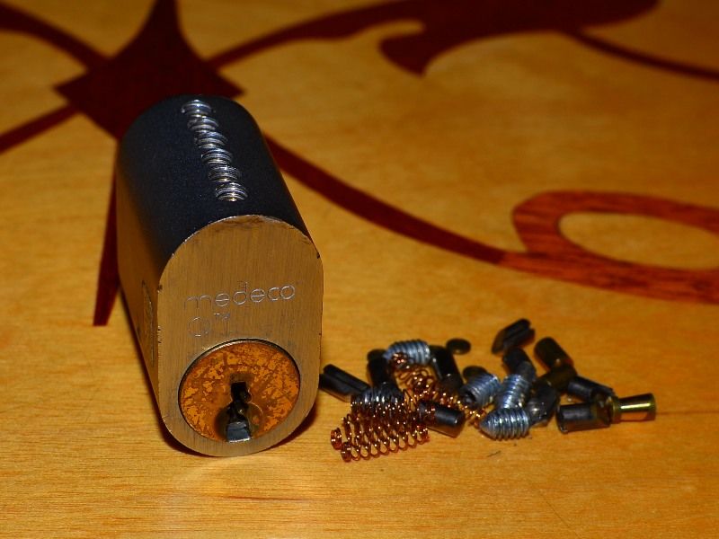

Wanted to ask you first before I grab my dremel and grind it open...
Here are all the pin stacks removed:
Now the plug turns but there is big torque needed at the beginning of the turn.
To help my picking practices I would like to make it smoother or take it away, so I need to open this cylinder. But.
It´s made solid, at least it looks like it. Is there a way to open this without destroying it?

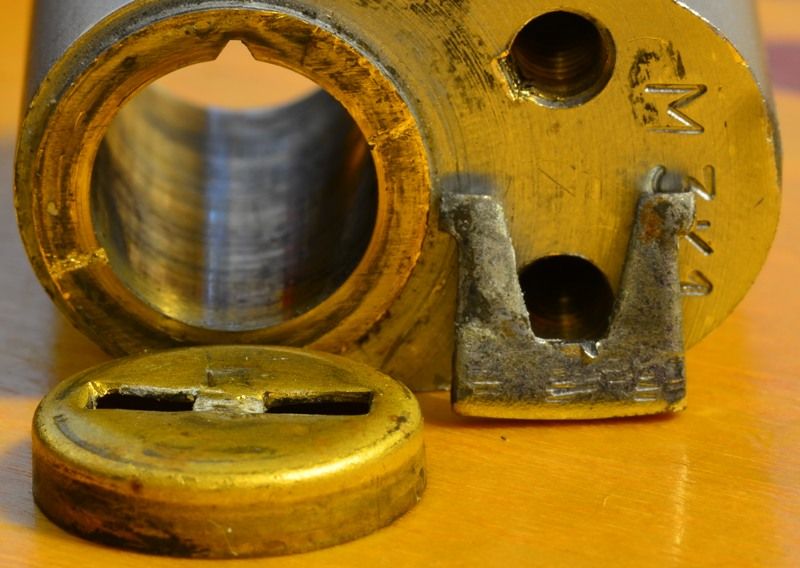

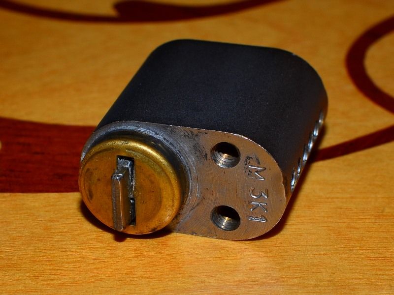

Is there a way to pry off the brass cap that keeps the tailpiece from falling out of the plug?
Re: How to open this Medeco cylinder?
Postby zeepia » 17 Dec 2012 13:32
Prying is not an option, it destroys the brass cap which continues below the tail piece. The tail piece is put there last.

That's just a cap isn't it? The normal plate with 2 screws should be behind it. Never seen this... not least a Medeco Oval :|

Thank you all for suggestions, guess I take my dremel and cut that brass cap off. But definitely that tail piece is put there last, therefore I don´t believe there are any screws under it. When I cut it in half, I maybe need to improvise something to keep it closed.

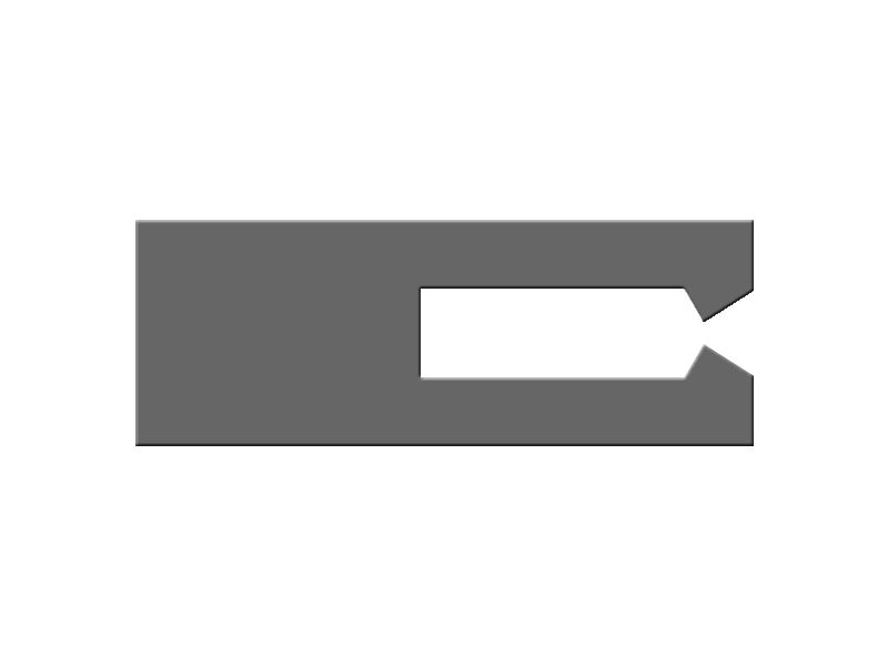

Maybe the tailpiece is shaped like this and can be simply pulled out with pliers?
Postby zeepia » 19 Dec 2012 10:06
That tail piece isn´t coming off just by pulling it, at least not easily. I might give it another try.

have yo utried unscrewing the brass cap? maybe using channel lock pliers (or vise grips)? the brass piece must rotate with the plug and the plug has to come out the front, hmmm.....
looking at the picture of the front of the lock got me thinking, perhaps while rotating 360 degrees you will ;come across a slot that allows the sidebar to escape? probably not, but you would be able to see it from the 'bottom' of the key way. it has to be the brass cap really, did you try turning it 90 deg and really giving it a good firm push from the rear?

Have you tried to push it through with the cap and tailpiece left on it?

Like Femurat suggested, it was shaped so that it could be pulled off. Or more closely, it could be pried off, pulling wasn´t enough. I almost hadn´t guts to use so much force but one must live dangerous sometimes :wink:
