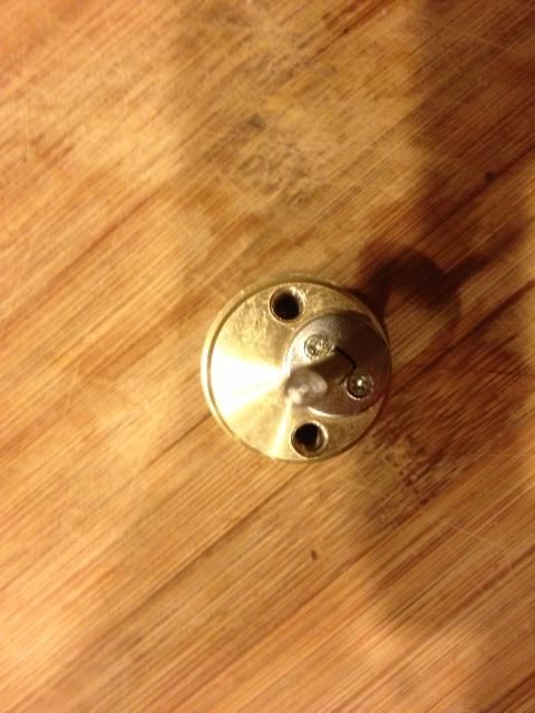

Lock #3: An unusual rim lock that came with this product http://www.nokey.com/foxstylpollo.html. The website lists this as a Corbin Russwin lock with a RUI keyway. This thing has a really long tailpiece that has to stick all the way through the door to connect to the cog that moves the locking arms. The tailpiece is also secured with screws instead of the usual clip.
At this point, I'm pretty well stuck. After much googling and questioning, I was pointed to this forum. Does anyone have an idea on how to get all of these locks to cooperate?

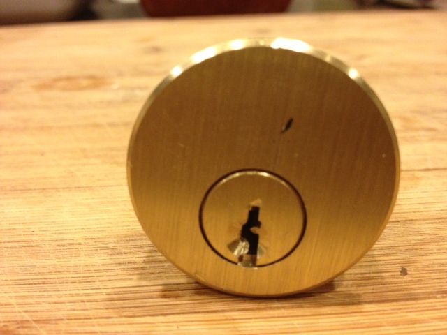

One more problem to add to the mix. Forgive me if this is a stupid question, but what do I do if the keys physically won't fit into the each of the locks? Not sure if this is the right terminology, but they seem to have different keyways.
I had assumed that I needed to replace the cylinders on one or more locks, so they would all have the same keyway. Is this correct?

The RU1 and Kwikset keyways look to be very different to me, although I'm not exactly an expert in this.

Actually the rim cylinder shown isn't using a standard tailpiece. Finding a replacement may require a bit more work.
