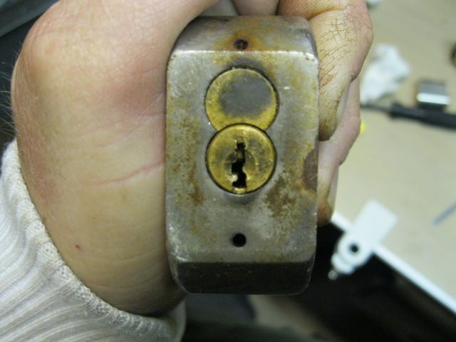

thanks for the info guys, i just opened it. still dont know what the guts look like, will have to work on clearing the hex screw of all the rust before i can open it up. will attempt this after work today. i figures out why i couldnt pick it- it took me so much force with a screw driver that i thought something was going to break, the thing was filled with rust, and muck i guess.

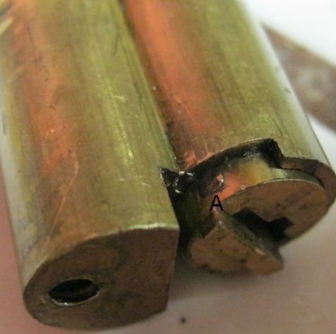

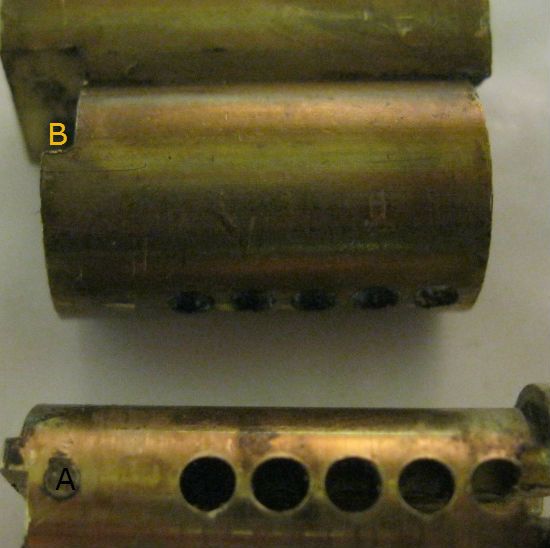

well, i got it open, not easily though. turns out it was as i imagined it was, a single piece unit- well 2, plug and body/bible all with the figure8 shape all the way down. in the photos 'A' shows a brass pin i had to drive flush to remove the plug, there are 2 at right angles to each other. 'B' shows one of the two stops that prevent the plug from rotating more than 90 deg.
