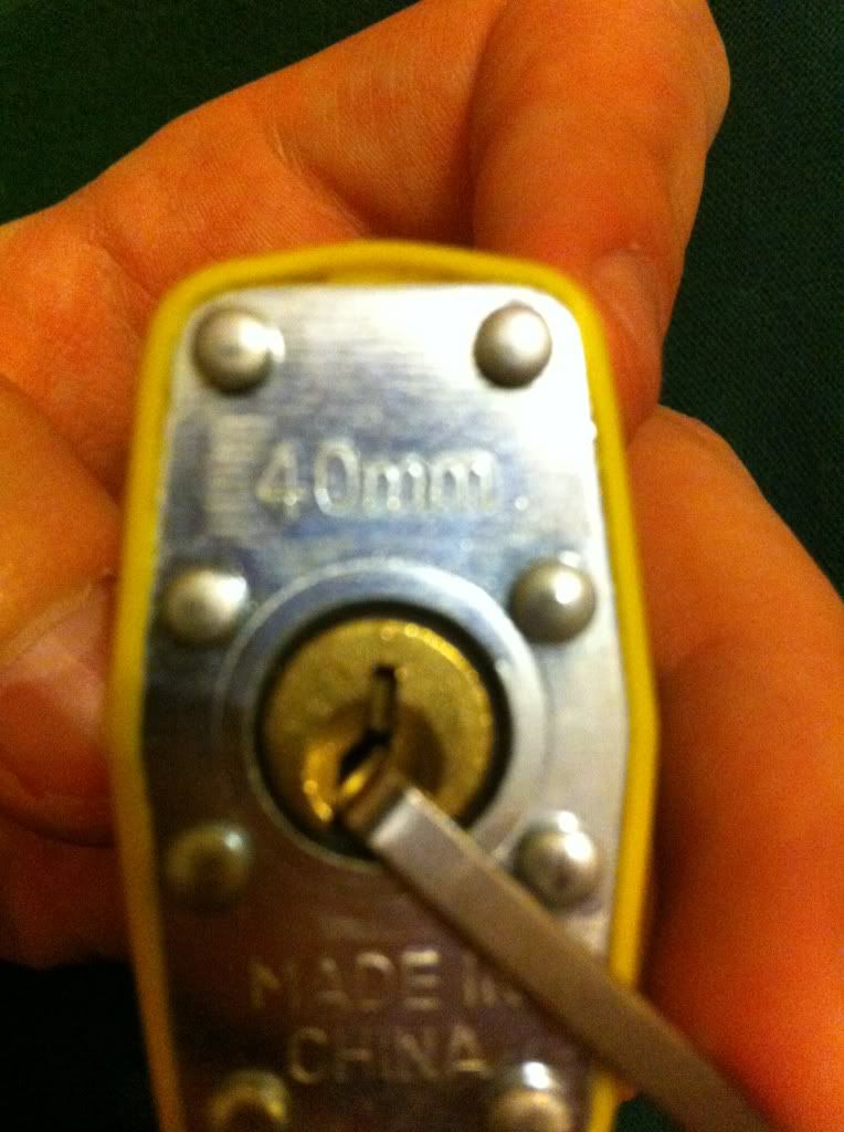

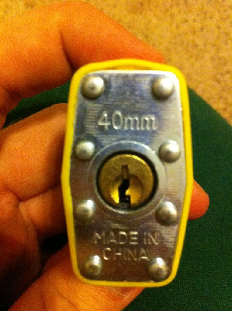

Pickmequick, while it is accessible and doesn't have very many side wards, I find it difficult with the tension wrench to find room to pick or to rake. I'll stop talking and post some pics... Oh and the third pic has the tension wrench in.
Any ideas or suggestions would be appreciated!

Postby Pickmequick » 19 Jan 2013 19:16
It is just a reverse of the master keyway.
Use top of keyway instead of bottom and file your tension wrench or make another as that one is massive.
When you put it in keyway, make sure it doesn't trap pin 1!

Postby Daggers » 19 Jan 2013 20:30
If it can open by turning left as well, then try having the tension wrench on the left side of the lock instead of the right so that it doesn't block the keyway. It'll leave much more room to work with. In my experience, most padlocks open both ways.
