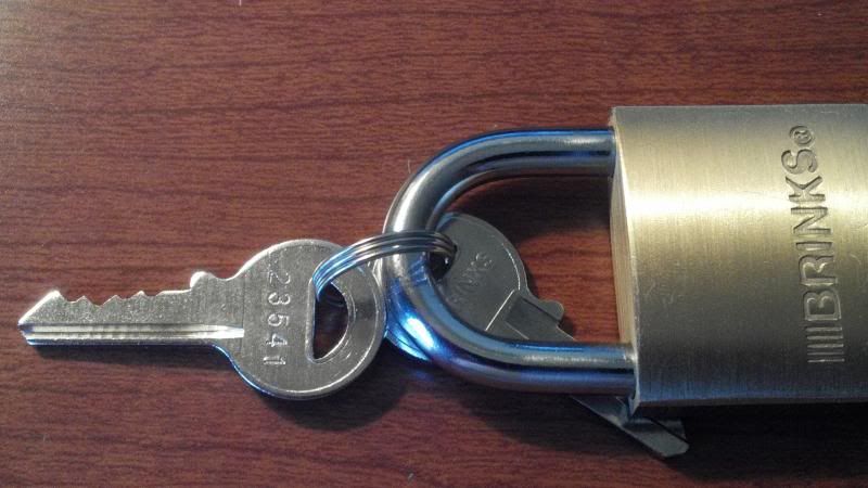

I'm still pretty new at this but I've been progressing in my skills and was feeling especially confident one day after having consistently opened every 4-pin master lock I owned, plus a couple of cheaper no-name locks, so I purchased a Brinks 5-pin padlock to give a whirl.
I haven't been able to SPP this lock yet much to my frustration, but I am able to rake it fairly consistently. The thing is, when trying to SPP this thing, I can only feel FOUR pins, not five. I've placed my half-diamond in upside down and pressed the pins all the way into their chambers and slowly removed the pick, and I can only hear and feel four pins falling back into place. It seems that the fifth pin is missing. I'm even fairly certain that I can feel the empty pin chamber.
On top of that, here's a picture of the key. I only see where there would be four pins. The picture isn't perfect...at the end of the key where there is some glare, there is a very tiny notch on both keys, and I can see where that might support the fifth pin, but I can't feel it in the lock itself.
Like I said, I'm still a n00b, so I may be misinterpreting what I'm feeling, but I'm wondering if anyone else has run into this issue? I've searched the forums here and found that some of these that were supposed to have security pins had only standard pins, but I haven't seen anything where a pin was missing.
Thanks!
-M

Well, looking at the code of the key, that tiny notch is a 1 cut on that key.
Notice that the cuts match the biting of the key. The higher the number, bigger bitting.
So a 1 would be a small notch. Don't know about brinks, but usually a tiny tiny notch is a zero bitting, as they don't necessarily mean "uncut". Can you insert a long hook there? You can feel the chamber? Or just the place where the pin should be?
It can be a production error. No idea... I don't know those padlocks, so I can't be sure if it's usual.
Are you able to disassemble the padlock? You could check and post here your findings :mrgreen:
Anyway, congratulations on your pickings!

I'm pretty sure what I'm feeling is the empty chamber. Forgive my ignorance, but how does that differ from where the 'pin should be'? I don't feel a pin, I don't get any feedback from that position when I use a hook (which is not my strong suit), and I only hear four pins drop when I use the flat end of the half-diamond.
I'm almost certain that this is a manufacturing defect. The packaging said this was a five pin lock. Unfortunately, I live in the middle of nowhere and don't know of any other pickers near me who could confirm what I'm feeling. I was hoping someone else had come across this issue. I might go back and buy another one from the same store, assuming they are from the same production lot, and then get another one from a different source to compare.
Does Brinks produce a four pin lock? If so, I wonder if they use the same cylinder but simply don't install the fifth pin. Maybe mine was mislabeled. Either way, this is the first four pin lock that I still haven't been able to SPP. I'm hoping there are spool pins in there that I can't get past...otherwise I'm REALLY not doing it right! :)

Wait, I know what you mean. Do I feel an empty space or an actual chamber. I'm pretty sure I feel a chamber.

Mikeh727 wrote:Forgive my ignorance, but how does that differ from where the 'pin should be'?
No ignorance. I mispelled.. AGAIN :mrgreen:
Do you feel an open chamber? Or you feel a hard spot? Like no chamber, just plain metal.
If there really is a chamber it can be factory defect or mislabeled like you said.
To know if there are spools. The classic way is when you are picking and suddently the plug rotates a bit and then stops. You then need to go over the pins and lift them one by one with little tension. When you "hit" the spooled pin, the plug rotates a bit back untill it sets and rotates the right way again. That's why light tension. To allow it to rotates back, without reseting other pins.. If there are more than one spool, repeat the process untill it pops open.
Sometimes (and it only happens with really cheap, or heavily picked locks) the driver pins get deformed and get a spool shape (thinner in the middle). They feel and set like spools if the tension isn't light enough. There is no problem as you act like if they are spools, and they should be even easier than real spools to overcome. But it's funny to encounter them because my first time with those, I was ABSOLUTELY SURE the lock had spools. When I disassembled I was confused. Then I noticed the deformations on some pins and deduced this.
On really rare occasions, the deformation may take the shape of serrations. And those my friend, are nasty :mrgreen:

One can definitely feel the hole for the missing pin with a hook pick. If you felt it once you won't miss it :)
Brinks usually makes decent locks, I have a limited scope on American made locks but my experience is that Brinks is better than master or American locks (especially since Master bought American).
(wow hard to refer to US made locks (American) and American locks made by American locks company) and avoid confusion. Best padlocks also took time to get used to.
It could be a production error but the reason why I think that's unlikely is that they had to leave the spring out too. A spring in an empty chamber will cause trouble as the bible turns. (learned that the hard way...)
Well it's still more likely that than they lie...
I'm not sure what it is! If there is an empty hole it's probably a productioen defect. But the key seem to be one for a 4 pinned lock (to me at least!)
I'd suggest to contact Brinks. And please write back here whaterver reply you get and whenever you get it!

ARF-GEF wrote:One can definitely feel the hole for the missing pin with a hook pick. If you felt it once you won't miss it :)
I'm pretty sure that is what I am feeling. Before I contact Brinks and get a 'canned' response from them, I think I'll seek out another picker or local locksmith to see what they feel. I'm new enough still that I might be way off on what I'm feeling, but I don't think so. I need a second opinion.
