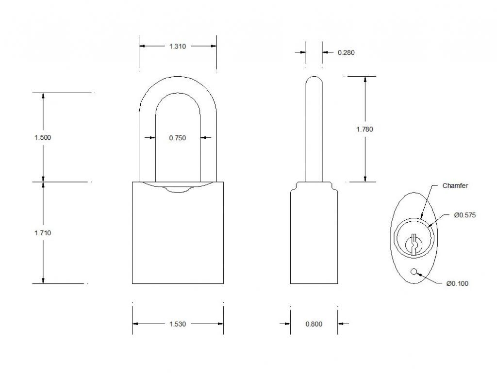

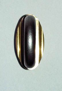

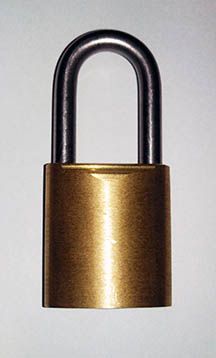

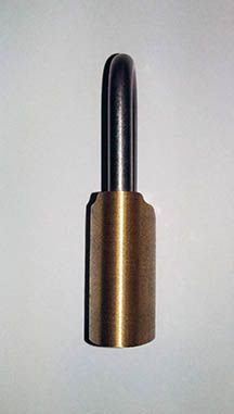

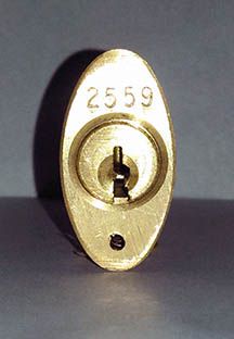

I'm a commercial/Industrial rental property owner, who is always dealing with locks of some kind. Whether it be tenants changing locks, or putting locks on things and leaving without giving me a key, it seems I'm always having to tinker with something involving pins and tumblers. Tenants? Yeah, they suck sometimes, but at least I get to satisfy my curious side and learn about locks along the way. Quite a fascinating subject to be sure, which is what has brought me to the site. So, enough lurking and reading!
Anyway, per the typical scenario, I had a tenant leave, but before he did, he went ahead and did me a giant favor by locking all but one of the overhead doors(6 Total) with this padlock. It's a solid brass lock. The only identifiable marking is a four digit code above the cylinder. "2559"
So, I was trying to find out some more information before I decide which approach(Pick, Bypass, Impression, Cut) will best suit my intrinsically curious nature and the available time I have. I'm also curious if they can be re-keyed, or if there is a key cut chart that corresponds to the stamped numbers.
Below are some pics and a CAD drawing I made(another hobby of mine) to assist the members of the forum in giving me some information and advice about this lock.
Thanks in advance,
Lawrence

If by "Re-Key" you mean to change the key which opens it now. I don't think so.
The 2559 is probably a blind code, and if we knew the manufacturer, could lead us to the cuts.
They appear to be pin tumbler so impressioning is a way to go.

As for the lock I think the number is interesting. I usually see the number on wafer lock, where it indicates the proper key cut. Ony padlocks the only numbered ones were either government padlocks or padlocks of major companies.

And here is my requisite drawing of the cylinder:
Thanks for looking, and sorry again for dredging up the past! ;)

Nice drawings by the way. I use sketchup for a lot of simple designs but it sucks for 2d. Do you have any recommendations for someone that just wants to draw simple sketches in 2d to scale with measurements? Preferably free? I use mac and pc.

+1 on the nice CAD drawings

Thanks for the compliments on the drawings. I have a background in Mechanical/Architectural drafting, and am a visual person, so drawing helps me understand things. I draw almost everything I take apart, different locks being just one of those things.
