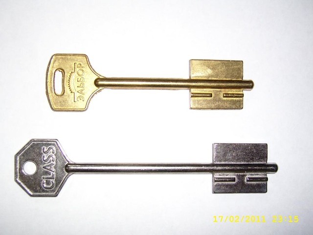

Postby kerti » 25 May 2013 8:36
About costs... For example. Here are two blank keys for that type of lock. Elbor and Class. You can see that it have not somekind finish. Brass or zinc alloy only.
