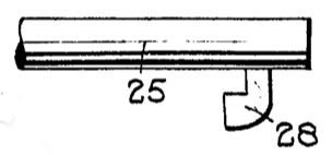

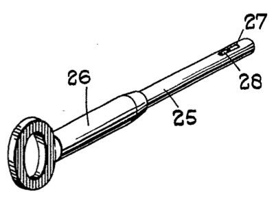

Postby GWiens2001 » 1 Jul 2013 22:37
Yes, they used to be used in the United Kingdom to secure the money in parking meters. The link above to Femurat's topic has a lot of information on the lock.
These are from the patent drawings of the key.
They were my starting point for the key.
