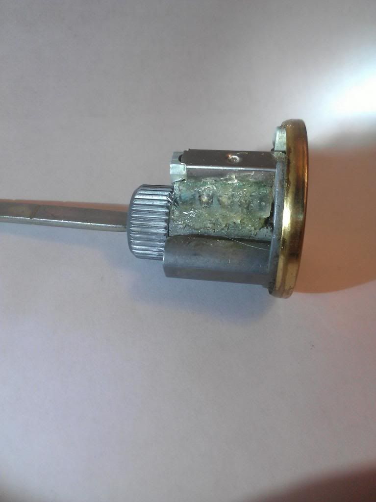

With my first attempt, the side of the bible was not perfectly flat, leading to uneven cuts and the holes allowing me to see the springs and driver pins being too large. Some springs kept popping out, so I used epoxy to affix a small piece of acrylic to the bible.
Ugly, but it does the job.

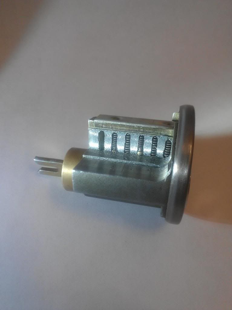

I tried the same method again, but this time I used a 5 pin Schlage deadbolt and was more careful to keep it level. I also stopped cutting with the mill earlier this time, since cutting creates a thin foil over the top of the cavities that is easily removed with a dremel. Basically, stop as soon as you can see into the pin cavities, since the holes will only get larger from here.
Much prettier!

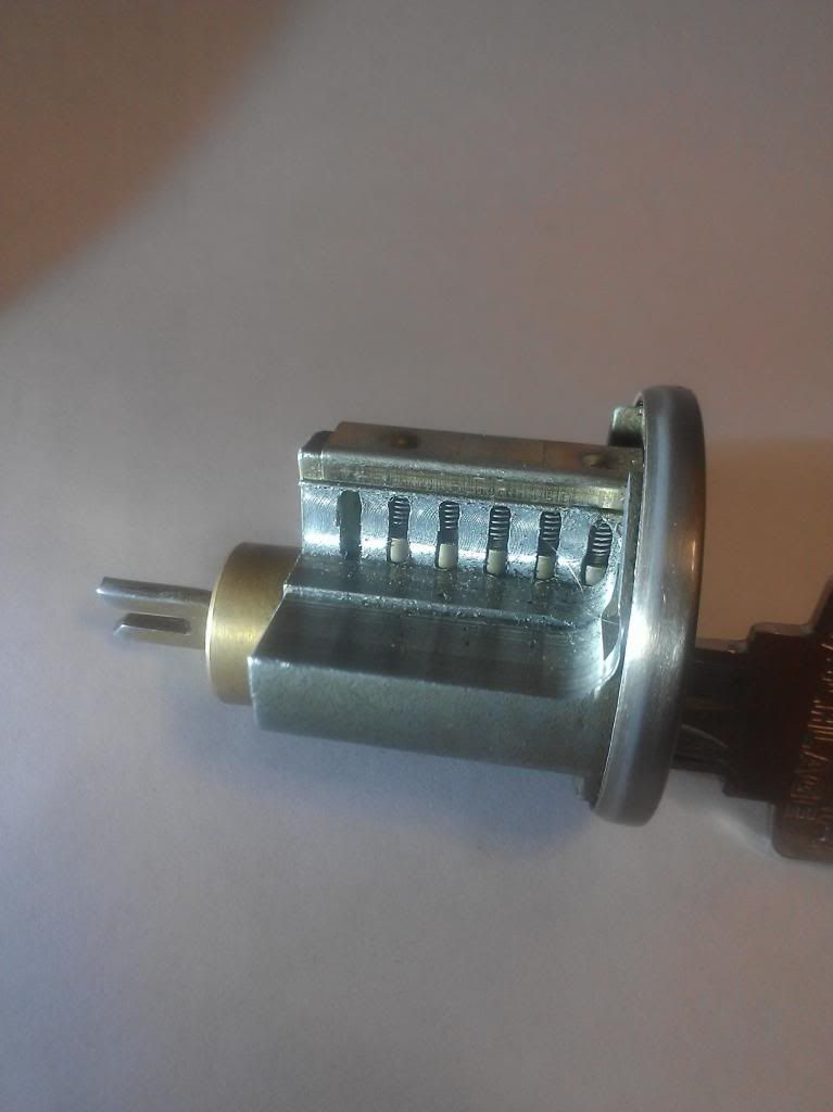

With the key. Very useful for showing how pin tumbler locks work.
Making cutaways this way was pretty simple. All it requires is access to a machine shop and basic knowledge of tools. I'm pleased with how the second one came out, and it's helped me improve my picking skills a lot, since I'm able to double check if the pin I'm feeling is set, not set, or overset. I am curious to know how other people made theirs, especially ones where you can see the plug and key pins. Also, the next time I make a cutaway, I'll be sure to get pictures of the process. Hope this helps, and I'd love to hear your tips!
