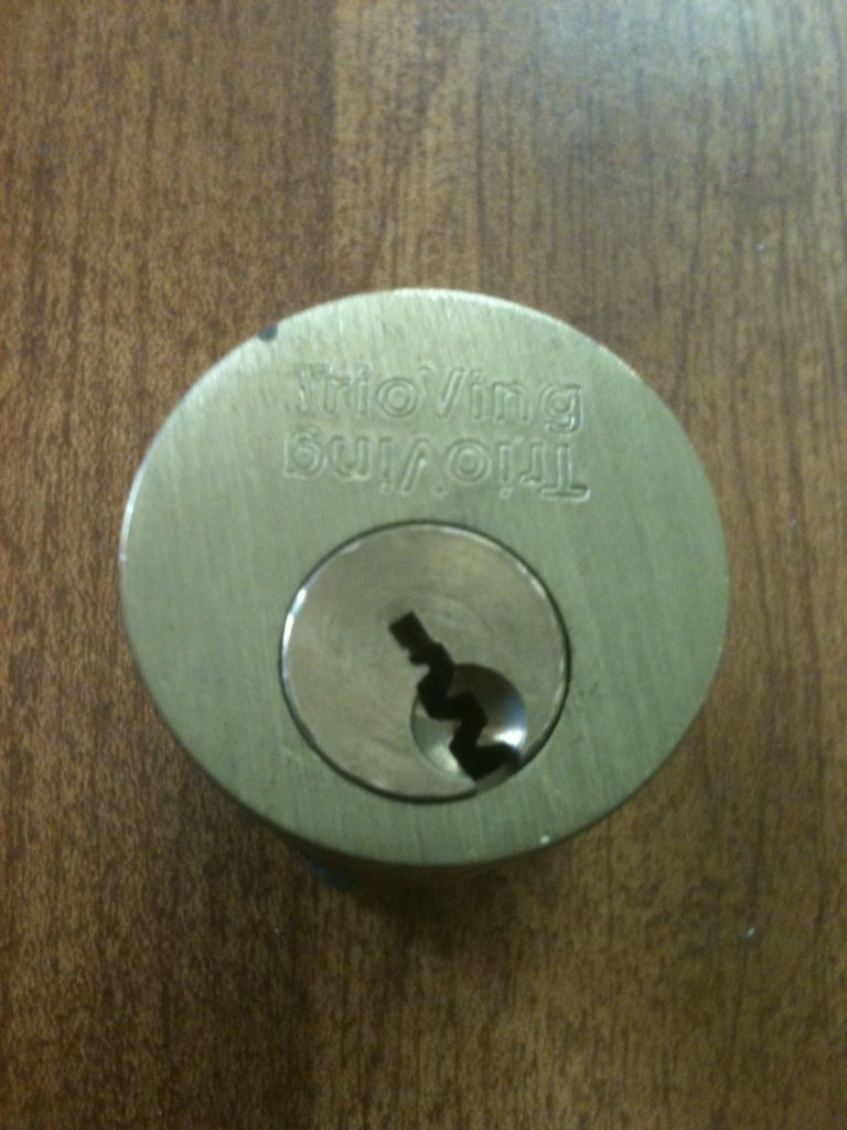

Another step up from things with standard spools or serrated pins would be the Assa 600/700 series (700 being 7-pin) or TrioVing locks. The crazy driver pins and sometimes countermilling in these locks make about as challenging of a standard pin tumbler as I've seen. They can be hard to find in the US but should be easier for you in Europe.

Postby fgarci03 » 5 Dec 2013 12:26
Holy!

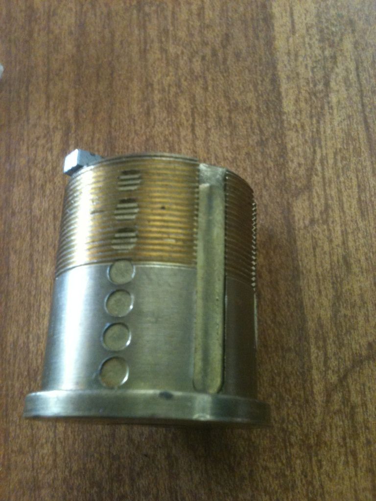

Trioving pins are an absolute nightmare! I managed to pick a lock with 5 of those (not an actual trioving) and they are indeed something!
@Mikus, you have made pins like those before:
Yours' had a serration in the middle, but trust me. It's not necessary to make them evil! :twisted:
Nice thought spandexwarrior!
- GWiens2001

Postby GWiens2001 » 5 Dec 2013 14:09
They refer to those TrioVing driver pins as trampoline pins. Mostly because you have to keep bouncing back and forth between pins. Setting one pin drops the others. :?
They are not picker-friendly locks!
fgarci -
Try it with seven pins. It will have you cussing in languages you never knew you spoke! :evil:

mikus wrote:I thought serration in the middle will make them monstrous (it is tough pin) :D will make six with serrations and six without and see whats harder :)
The serration will naturally make it more difficult. But my point was that it was a nightmare even without them :mrgreen:
@Gordon: Thank you for ruining my day with those pictures! :mrgreen: :mrgreen: :mrgreen:
Haha FG, don't worry we all know Gordon guts those locks with the key and takes a pic of the empty lock... :lol: :lol: :lol:
Just kidding of course, nice work there my friend!
