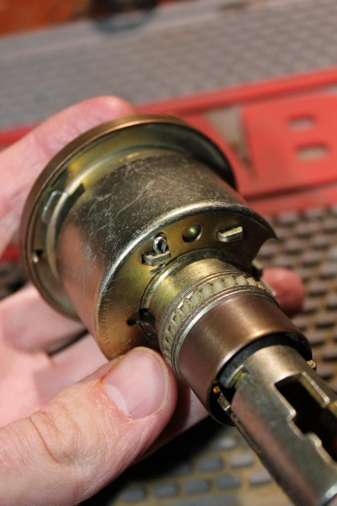

Next is the matter of adjusting for door thickness. On both knobs the outside rose threads on in order to accommodate doors of varying thicknesses. However on the Schlage the common door thicknesses are marked out. Also, the outside rose will catch every 1/2 turn preventing the likelihood of the rose spinning while installing the lockset. The markings are then aligned with the chassis cover (not pictured below)

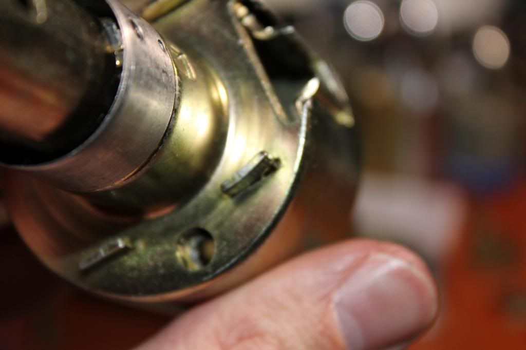

As for securing the chassis both locksets utilize four tabs, all if which penetrate the chassis cover. On the Arrow, two of these tabs are twisted using pliers. On the Schlage one of these tabs has a hole in it. A cotter pin is then inserted through the hole.

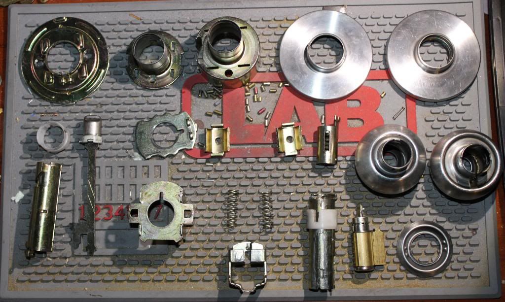

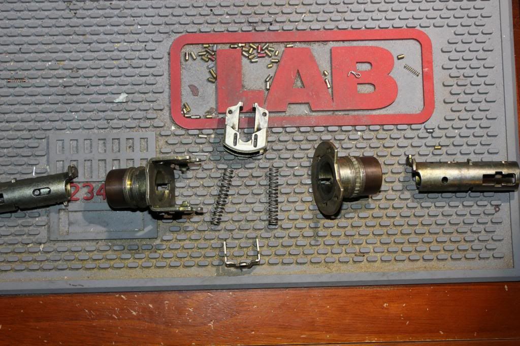

Also, for your viewing pleasure I have photographed the insides of both locksets. The Schlage shows just the chassis sans cover (as it is fairly simple) while the Arrow shows all the parts.

Arrow uses a bent piece of wire as a retainer for the tabs instead of the cotter pins that Schlage uses. There will be a hole drilled through the tabs and the wire goes through two diagonally opposing tabs. There are many locks that look similar and are made overseas, such as General, LSDA, US Lock, Cal Royal. However since you mentioned the need to turn the knob it made me think Sargent 6 Line, the older ones required you turn the knob to reach the retainer.
