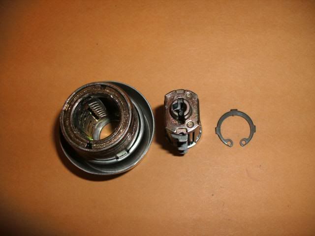

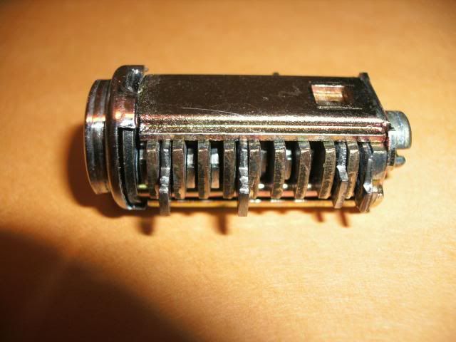

I was looking for key blanks for this non-magnetic MIWA cylinder and decided to put some photos here.
It was pretty easy to pick. The plug comes out the back of the lock after removing a snap ring. Each wafer must be picked to clear the back of the case. There are ten wafers that can be moved around to change the combo.

Very nice lock Ray, never saw one of those before!
Serrated wafers give me a total headache, much more than serrated pins... But I do have only tried them on one lock, so I'm not sure if they're all difficult.
Thanks for sharing :mrgreen:

Very nice! Thank you for the pictures. Did not expect it to be a wafer lock. :shock:
There are blanks like that in the ILCO catalog, if I remember correctly.
