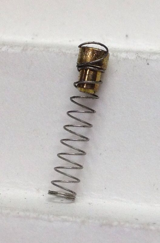

Hey everyone, I took apart what I believe was a Schlage F-Series door knob lock today, it had the floating bible cap with the T pins that fit inside the spring. However, one of the pins was different than all the rest (the pin and spring on the top in the picture). The other 4 pins and springs are all the same and are on the bottom in the picture. Whats with this odd pin/spring? Is it an anti bump pin/spring? TIA.

Unless the spring is much stronger than the others I can't see it working as an anti-bump pin.

It seems stronger but not by that much. I was told the door knob has never been serviced, but I don't see how a different pin/spring would get inside the lock. Maybe there was a point in time where Schlage used a sinlge normal pin and not all T pins. Was just curious to see if anyone had seen it before and would recognize it.

What had to have happened. When it was taken apart some of the springs/pins got lost and whomever was working on it made do with whatever they had. The Top (silver) spring is the correct spring and the bottom (T) pin is the correct driver pin. There is suppose to be five of each in that lock.
Anti-bump pins with stronger springs (Ilco makes them) won't work in a schlage F series with the compressible spring caps. It would push the cap right off.

That makes more sense. Thanks for the info.
I bet this is what happened when the lock was serviced the first time. Found this yesterday in an F series. The pin was jammed up in the bible not doing anything.

wow that's pretty nuts. I am surprised that the floating cap stayed intact with the cylinder after having the driver pushed up with so much force that it buried itself into the spring. From what I have heard, those floating caps fall off pretty easy.
