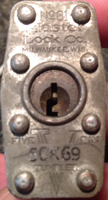

One lock with 5 non-security pins is a Master no. 81

Have not seen a Master No. 81 before. Interesting. Wonder how many Master No. (x) there are.
