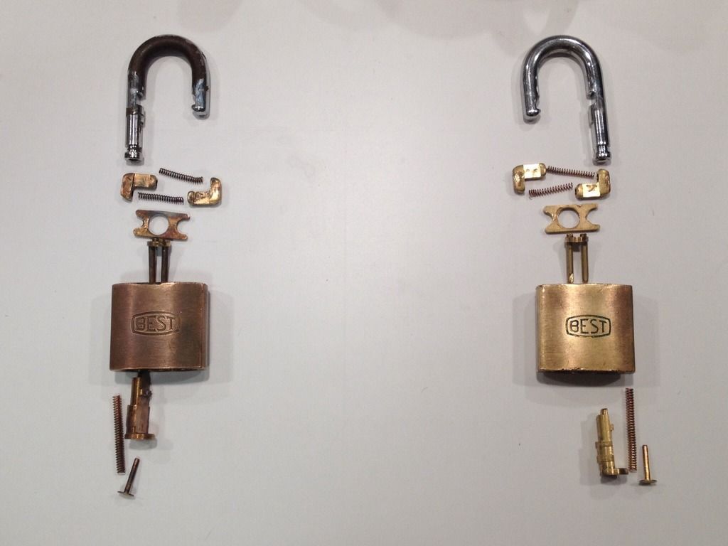

Postby Robotnik » 19 May 2015 1:45
Wanted to give credit where it was due: there's no way I would have got these two padlocks disassembled without this guide. Thanks again, and hopefully assembly goes reasonably smooth.
The lock on the right fought me hard. Think something was seized up; nothing I did would dislodge the shackle retainer, even after rotating. While it may not be canon, I finally turned the shackle 180 degrees, hung it over the lip of a rubber mat, and gave it several solid strikes on the top of the shackle with a dead blow hammer. Millimeter by millimeter, the shackle retainer finally gave up the ghost.

Postby GWiens2001 » 19 May 2015 5:03
Nice job, Robotnic. They can be a major pain to get that retainer out.
Think you will get it back together just fine. Great pic, too! 8)
