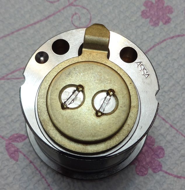

I am working on a holding cell for Homeland Security after two other "locksmiths" gave up on the job. This one uses a spacer where a #14 Assa cam would normally go. AFAIK they do not make cams to put this cylinder in a Sargent Mogul lock if you are using the longer cylinder with the spacer, at least I can't find anything. Hopefully I am wrong and just not searching correctly.
A previous locksmith took his dremel to the cam, notice the gouges in the housing and whatever he did it no longer works. I am thinking to fabricate a new cam out of an old brass ANSI strike plate using a #14 cam as a template.
Anyone have any experience with this sort of situation?

Best I honestly know is to refab a cam. Best to get good measurements and have a few machined for you (if you fix this you will get called back for others). You can however make one by hand depending on how much spare time you have. If you're not busy right now go for it but as you probably know, don't put off paying jobs to sit with a file in your hand if it makes you less money.

I can whittle one out in about an hour. It will get us more work though from the property manager who handles most outside stuff at our airport and a few other facilities in the state. I am willing to lose a bit to get a foot in the door. I just won't have the lock or cylinder to test it on in my hand so I need it to work first time.
There are 5 other locksmiths and a helper for other jobs so I can work on it between customers and dispatching at the shop. Also useful to talk the boss into buying a milling machine.

OK here's a line drawing 1 1/8" Sargent Mogul cam. ASSA says they do not offer cams for the 1 1/2" Mogul cylinder, and Sargent says neither do they. Why only they know. The radius is 1.043" so I should be able to make something.

I haven't tested it yet, but here's my cam, hand filed from a brass strike plate, plus the correct 1 1/8" cam and the odd cam that I found on the cylinder that didn't work. My cam is the one in the middle.
Re: Assa Mogul
Postby cledry » 3 Jun 2015 17:01
OK, my cam worked perfectly, I had to thin it slightly but the length was exact.
