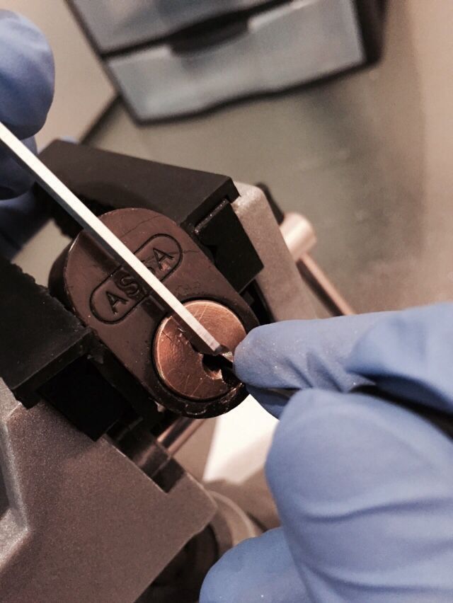

I've been struggling with this lock for a few days now and thought it's about time I ask for some advice. I am stuck at a false set after lifting the 4th binder. I can take out my tension wrench and the core stays in the false set without returning to zero. I have to rotate it back with the wrench to restart. This is my first encounter with threaded chambers and ASSA security pins so any advice would be greatly appreciated. These sure don't pick like American, Schlage or even Abus security pins.

I'm still stuck at a false set. Just to clarify..... I'm using TOK tension with a Peterson gem. The sequence of binding is 6,1,2,3 with big turn of the core and I'm stuck. There is zero feedback from the pins after hitting pin 3. The big question is..... How do you avoid or counter the pins getting cought in the counter milling. I know how to ride the tension as I push up spools, I've tried bringing the core closer to 12 o'clock position after the false set hits but no luck with releasing the stuck pins.

Update: I have broken through the wall but yet to open the lock. The trick is the have an extremely tight fitting tension wrench. The core needs to be rotated to extreme precise angles to push past the counter milling. There is zero feedback from the spools as you push up on them so I have to find a binder and very slowly rotate the core back closer to 12 o'clock position, hoping not to undo everything I've done so far. Will keep you guys posted.
