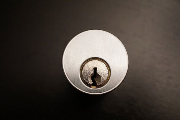

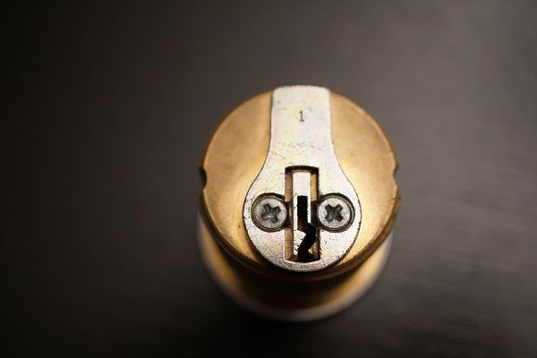

Is there a 7 pin key out there for the schlage C keyway? Reason I ask is because of this practice lock I purchased on ebay.
I can use a 6 pin key with a #9 pin in the last chamber but that's a little underwhelming. Now a #9 pin in the 6th position and a #2 in the 7th would be a little more devious!
Also, has anyone seen these locks in use? I can attest that with radical bitting and security pins these things are quite difficult to open without a key.

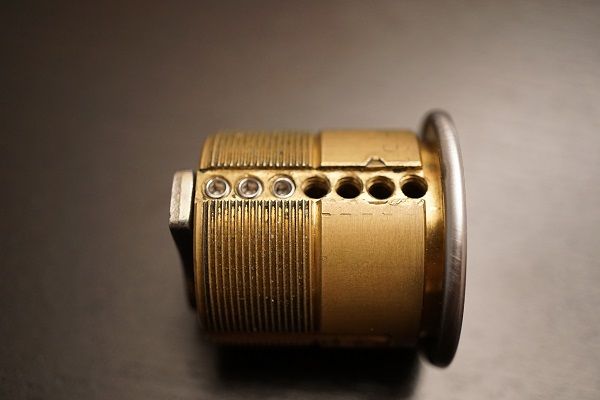

There are 7 pin blanks, or you can file back the shoulder of a six pin blank.

There are not 7 pin blanks per se, however there are control blanks which have a fixed depth in the 7th position.

The lock itself is a 7-pin generic cylinder manufactured by Ilco.
Typically "drilled 7, pinned 6" for the generic cylinders of that length.
Ilco produces cylinders like this because several other OEMs (Lockwood, Yale, Sargent, Corbin-Russwin) have 7-pin keying systems and they simplify manufacturing processes by making cylinders in those sizes the same way.
You won't find 7-pin Schlage C keyblanks but like others here have said you can use a 6-pin LFIC control key blank for this purpose as long as you are aware that you won't be able to key the locks to certain bittings in the 7th chamber.
~~ Evan

kkarkid wrote:I'm thinking about building one of these. Does anyone know what the Ilco part number is for this cylinder?
Just order a Ilco 1 1/4" Schlage mortise cylinder. It will come drilled for 7 pins. 7205SC1
