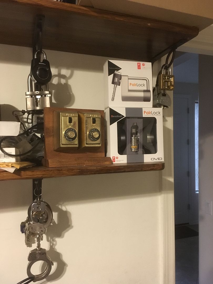

Here is a post on the PairLock on the padlock version. :wink:

That's a pretty interesting concept. I ordered the padlock just for the weirdness/take it apart and play with it factor. The door and deadbolt I wouldn't use to lock up my home, though.
