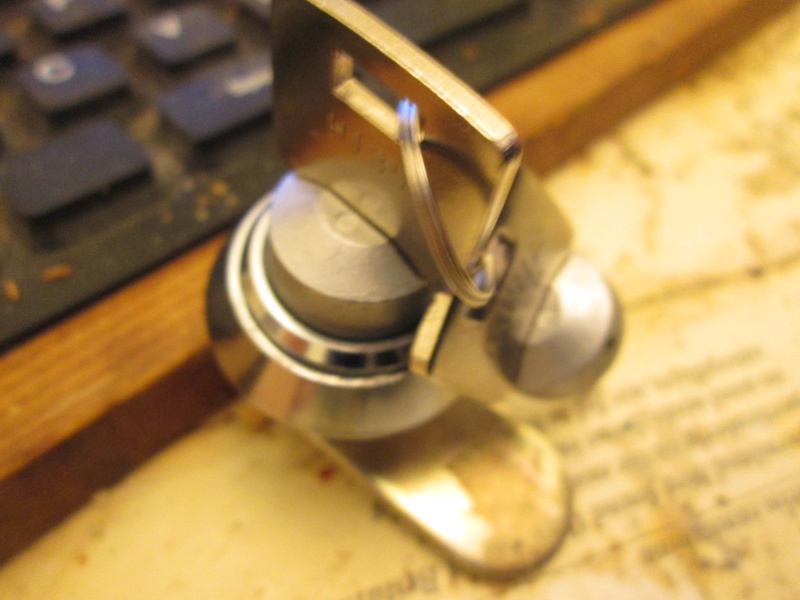

Postby huxleypig » 16 Jan 2017 18:15
I do not know its name and I have asked quite a few people. The magnetic part of it works differently to the 3800 but it is here:
There are magnets in the face of the lock AND in the key, meaning that the key magnets need pushing,pulling or leaving alone (blank). If you make the key non-magnetic then you lose the ability to push, you just have pull or nothing.

Postby MiPo » 17 Jan 2017 13:27
Very nice, thank you for the pictures. Have you gutted it?

Postby huxleypig » 17 Jan 2017 22:08
Ha, yes I have gutted one of them. I know how it works and it is rather convoluted. Not as much as the 3800 but almost. There are some pins in the face and they are magnets that either need pushing or pulling (and can be N or S). There is also just a metal pin, which would require pulling (N or S, doesn't matter) and I see that as a blank because anything magnetic in the key will work.
When you gut it things become a real PITA. To re-assemble requires a bespoke magnetic rig on the outside of the face of the lock; the key will not work because the pins that require pushing get thrown out the lock by the pushy key magnet. You actually have to reverse the polarity so that the 'push' pin actually gets attracted to the face and so stays there when you try to put it back together. It's very annoying.
