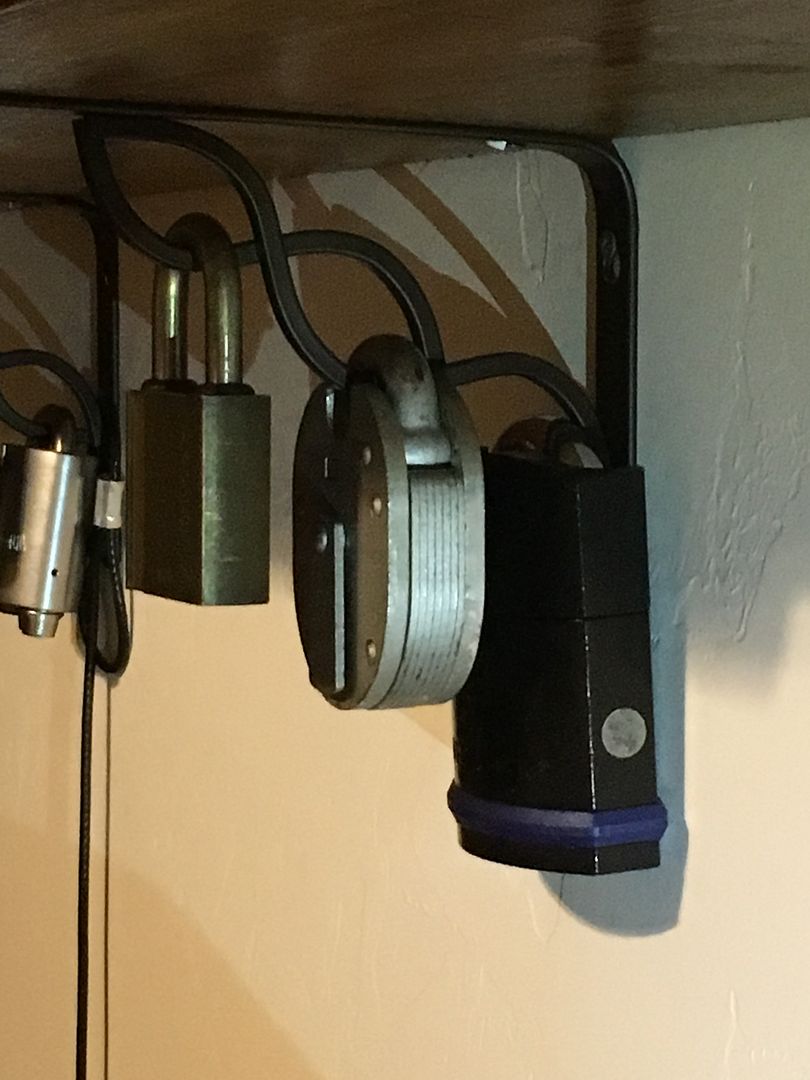

Is it just the picture or is that bilock bigger than the chubb & almost as big as that mul t lock e18? :shock:

G-lock wrote:Is it just the picture or is that bilock bigger than the chubb & almost as big as that mul t lock e18? :shock:
The BiLock is the smallest of the three locks. But the bracket is angled, and the front lock is closest, so it looks larger. Here is the same bracket with the same three locks, but from the side view instead of the front:
