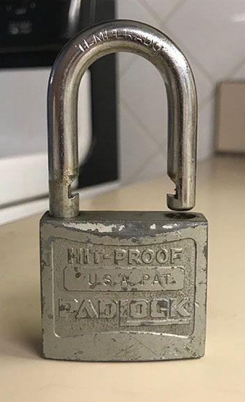

I bought a group of four of these shackled together with no key. Pretty worn - I had to use WD-40 to loosen the plugs on two of them. Doing a search here brings up only one mention of them, and elsewhere on the internet info is scarce. Anyone have experience with these? Are these rebrands? Do they tend to have security pins?
Another general padlock question - I notice some of these locks will turn just a bit and spring back before picking. Do you lift and then turn, or turn and then start lifting with these?

Did you try shimming one just to see if they have spring loaded shackles?
They might use ball bearings, but it might give you a bit more insight if you can get them open in general.
Also, the one at the bottom of the picture looks like it has a key. Am I seeing things? Does that key not work?

Sorry, that was the eBay pic. The key is a blank. I don't have a shim (it's on my list for the next time I buy a batch of tools) but may try making one out of a coke can when I get home.

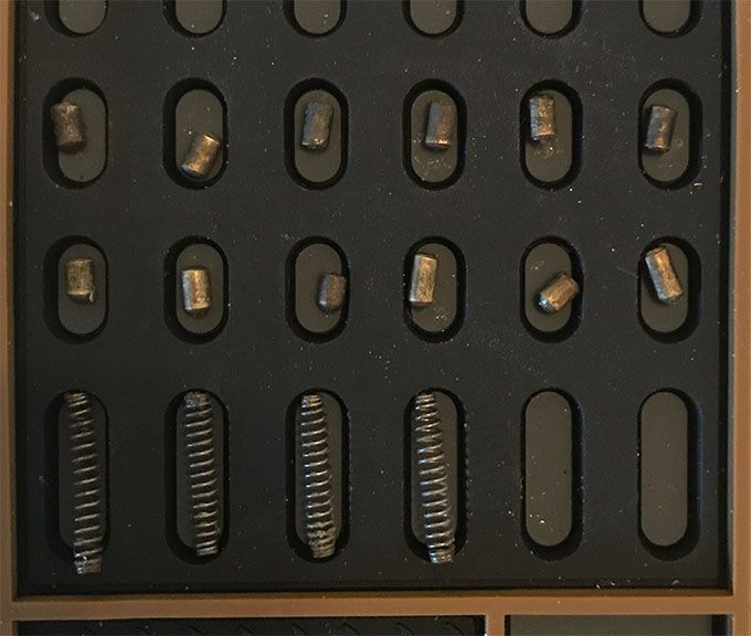

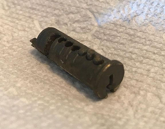

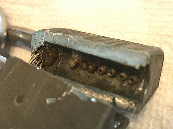

Well, after getting frustrated and then quitting for a couple of weeks, I picked these up again and got one open on my first try. Since there are three more and two are looking kind of rough, I decided to cut one open and share pics.
Nothing special inside, just 6 standard sets of pins. But one thing I've never seen before that I thought was interesting is that there's no standard bible - there are holes actually cut into the inside of the lock for the springs and driver pins. The last two springs were jammed way in there so I said screw it to those.

Postby mh » 22 Apr 2017 14:54
I think the way the holes are drilled into the padlock body is pretty much the standard way for a padlock.
mh
Moderator
Posts: 2442
Joined: 3 Mar 2006 4:32
Re: Anyone know anything about old Pado locks?
Postby kwoswalt99- » 22 Apr 2017 15:27
mh wrote:I think the way the holes are drilled into the padlock body is pretty much the standard way for a padlock.
Most brass padlocks are made this way.
kwoswalt99-
Posts: 1218
Joined: 17 Mar 2015 15:35
Location: Somewhere.
Postby Eazy123 » 22 Apr 2017 16:04
Well now I feel dumb. Lol. Didn't realize.

Postby adi_picker » 22 Apr 2017 20:51
Gday Eazy,
What the others have said above is correct, most padlocks are made in this manner with the body as the bible. Usually, if you look at the side of the padlock that the blade of the key point to, there will be little brass plugs covering the pin holes, or a small plate.
Something like this.
This is the padlock in 'Locksmith Form', before it has been keyed, and any pins inserted. Once you have placed all pins and springs, you will then hammer brass plugs into the holes. This also works the other way, in that you can identify, and drill out the brass plugs to remove the pins. I use a 2.5mm drillbit myself, as it seems to grab the old plugs and withdraw them pretty well.
Here is another example, with a plate covering the pins.
The above image is from this thread, about repinning Tri-Circle locks.
I suspect you will find your Pado lock has one of the 2 above, and you can drill and repin if you so desire.

Postby Eazy123 » 22 Apr 2017 21:56
Thank you adi_picker. If there were plugs on the side I would have suspected that, but on these there is a long silver stripe going down the entirety of both sides. I had thought they were merely for decoration, but now after reading your post I'm betting one side is actually one of those plates and if I removed it I would find the holes for pin chambers. Learned something new, so thank you!

Postby Ralph_Goodman » 27 Apr 2017 11:27
Nice to see you got it open.
Surprised to see 6 pins.
Looks like it could be shimmed (unless those shackle cuts are made to look deceptive).

Postby Eazy123 » 27 Apr 2017 18:33
Ralph_Goodman wrote:Nice to see you got it open.
No ball bearing but there is a sort of shaft that extends into the shackle cut. So I'm guessing shimming is an option.
