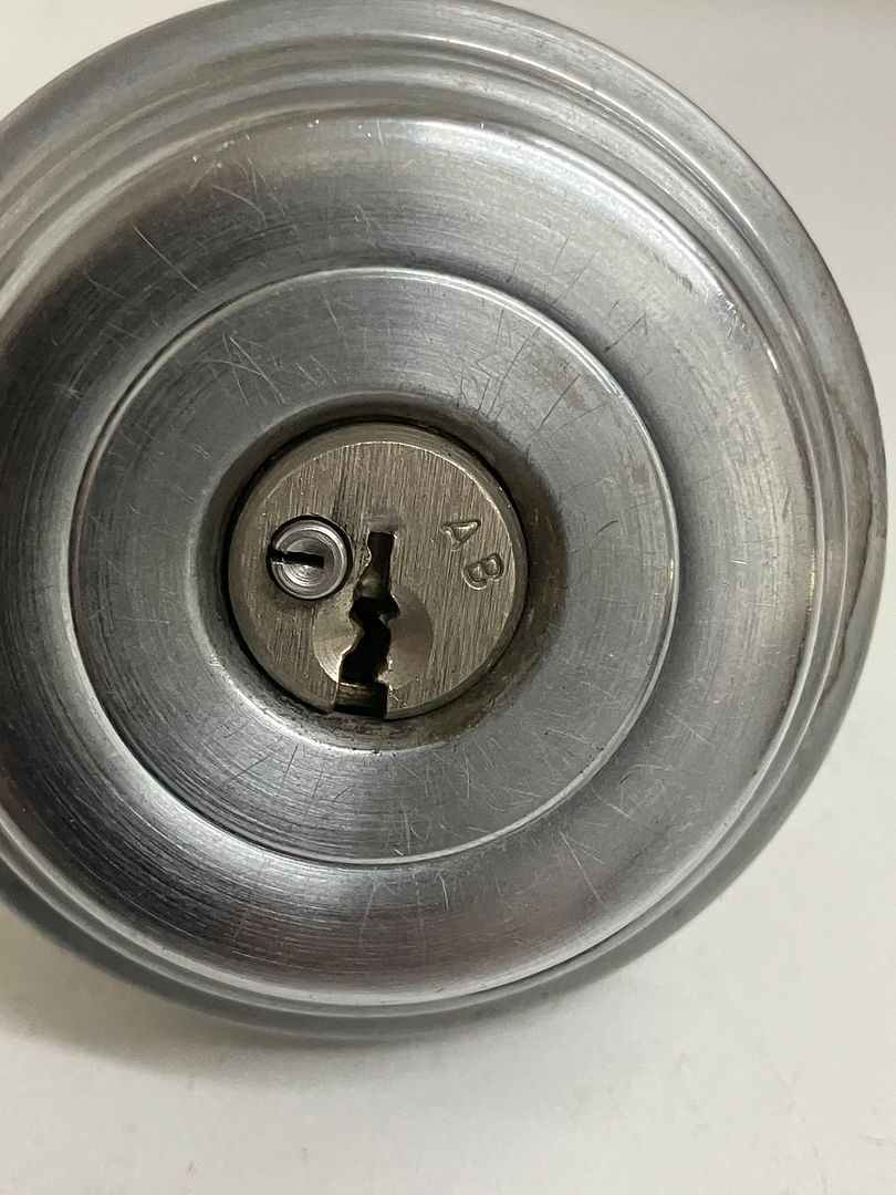

Here is your first look...

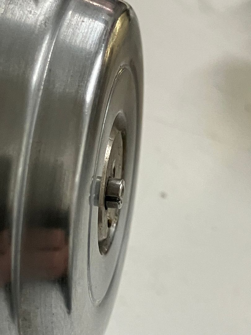

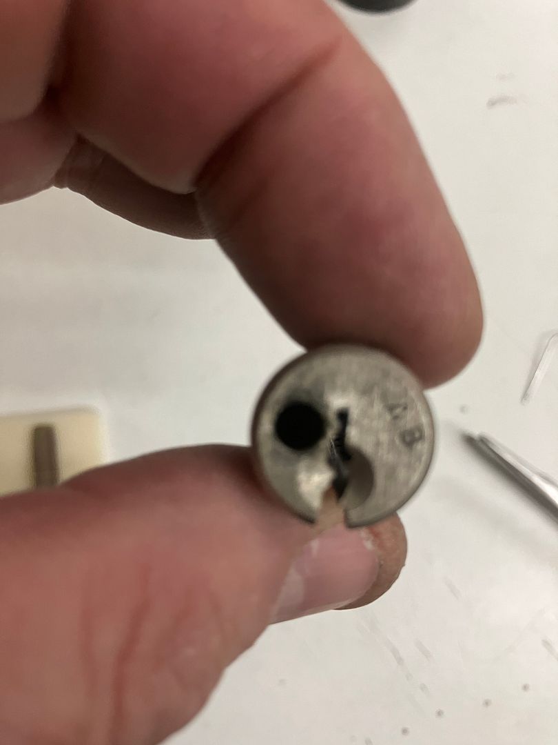

Yes, that is a button that sticks out from the front of the plug.
This particular example is a KIK cylinder installed in an Arrow deadbolt housing. So from this point on, the pics will be of the KIK cylinder.

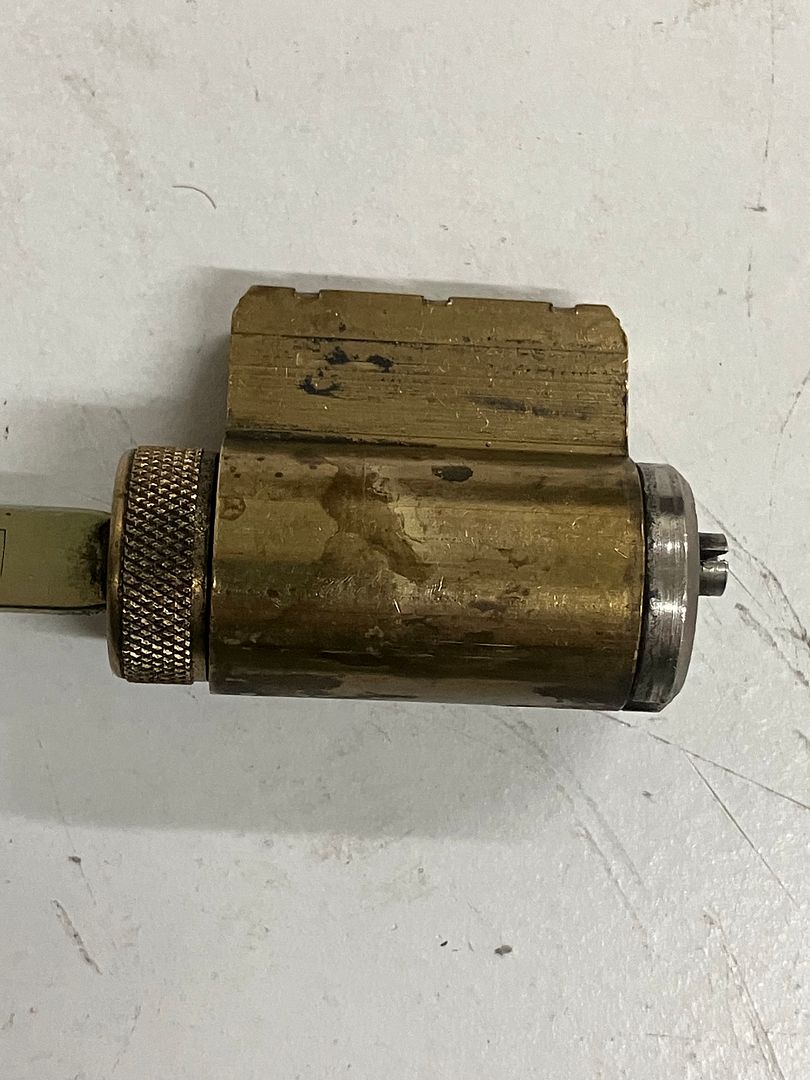

Here is that button. It presses in easily, though it does not do anything at this point. Will explain it further later.
It comes apart like any other KIK cylinder with a screw cap. Everything about the bible is normal except that the bible is set up for seven pin channels.

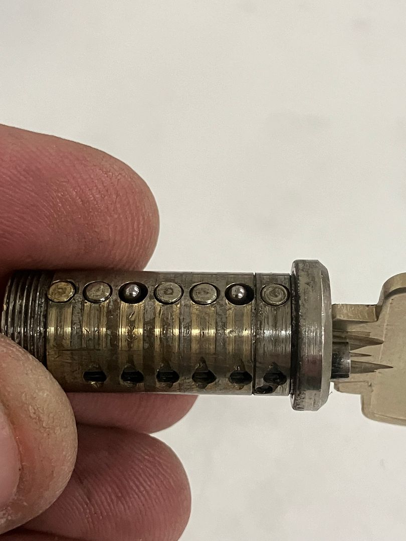

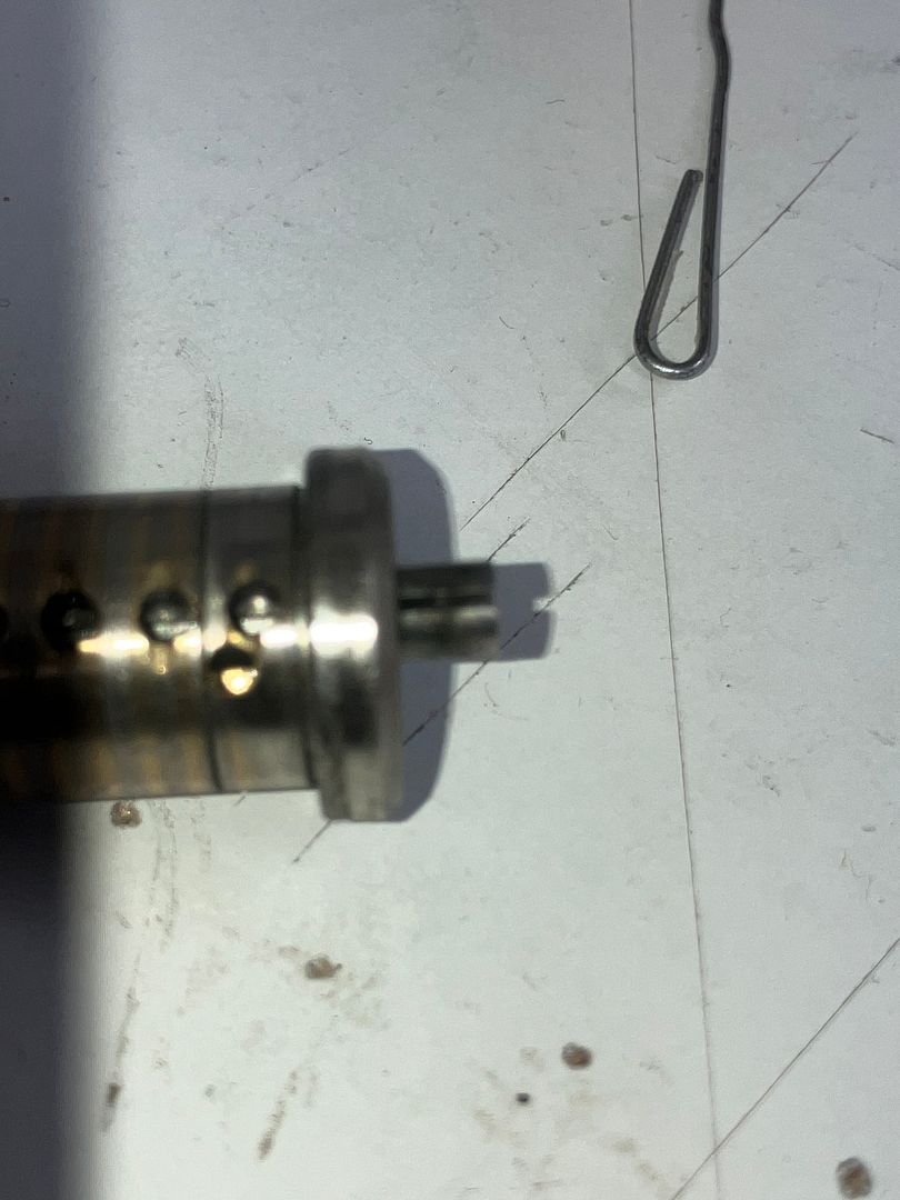

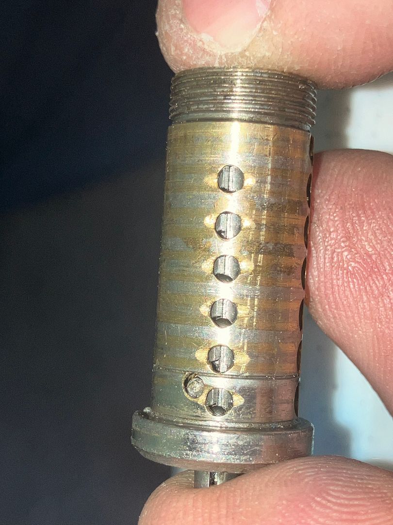

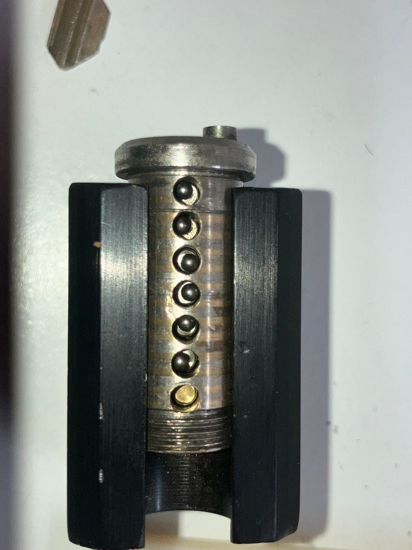

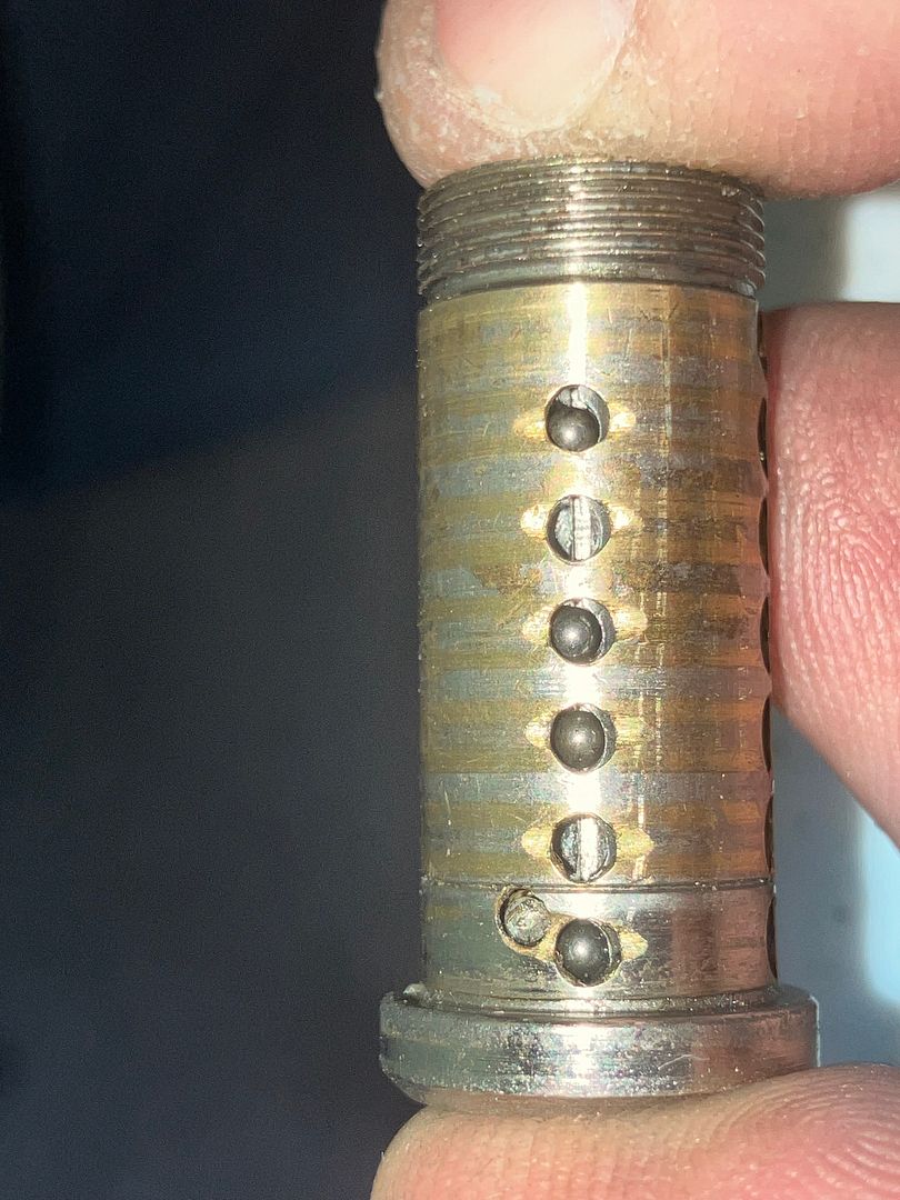

Looking at the plug, you can see that there are seven pins, with the second and fifth pins also having a ball bearing as well. Notice that there are six, not seven, smaller pin channels.

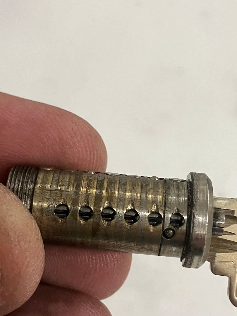

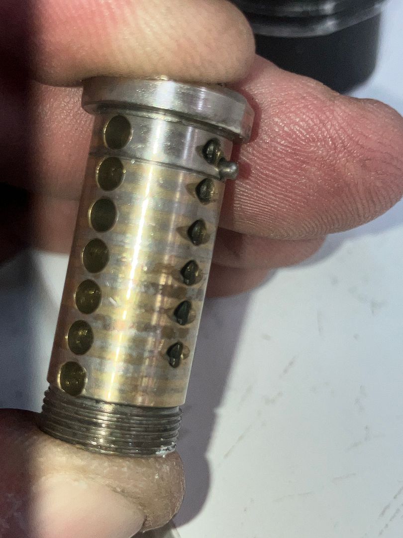

Here are the smaller holes you could barely see in the above pictures. Also, between holes 1 and 2, there is a smaller hole below the other line of holes. This is for a retaining pin you will learn more about shortly.
Now the front of the keyway is pointed down. These are the smaller holes . Inside them you can see that the button goes past all six pin holes. In this picture, the button is not yet pressed.
With the button pressed in, you now see that there are balls in the first, third, fourth and sixth of those holes (specifically, not the holes that still have balls on top of the key pins.

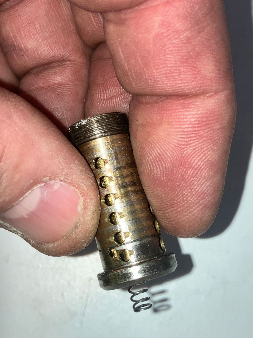

To get the trapped balls out of the side holes of the plug, simply point the plug with those holes down and push the button (have a tray or bowl below to catch the balls). Tap it a couple times as needed and the balls are removed. If you are only resetting the lock so you can get back to the first key, put those balls back onto the key pins in the plug and reassemble. Done! Easy.

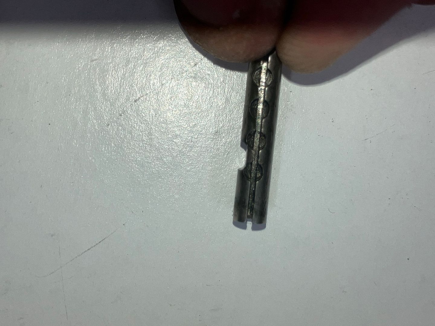

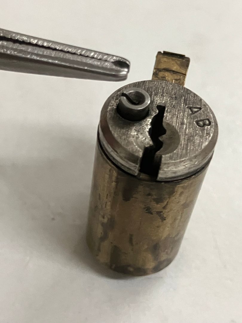

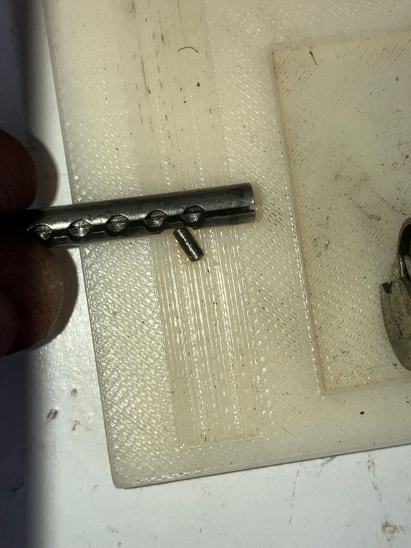

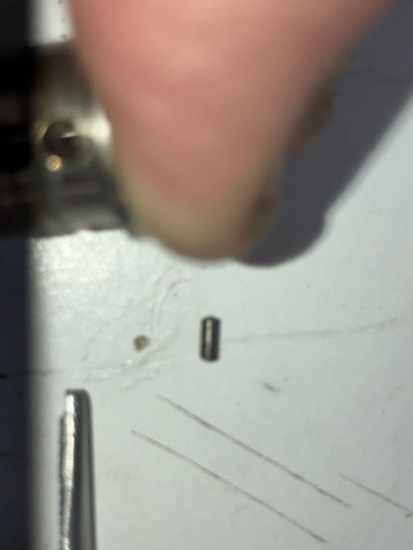

Turn the plug on its side with the button at the bottom and pressed in as you did to remove the balls. Tap the plug firmly on a piece of wood, and this pin will start to come out of the tiny hole below the first and second holes we mentioned way up near the top of this post.
You may need to use tweezers to grab the pin and remove it. It is not a tight fit, it will slide out, just not as easily as the balls.
Now when you release the button, it sticks out further than before.
Go ahead and pull it straight out.

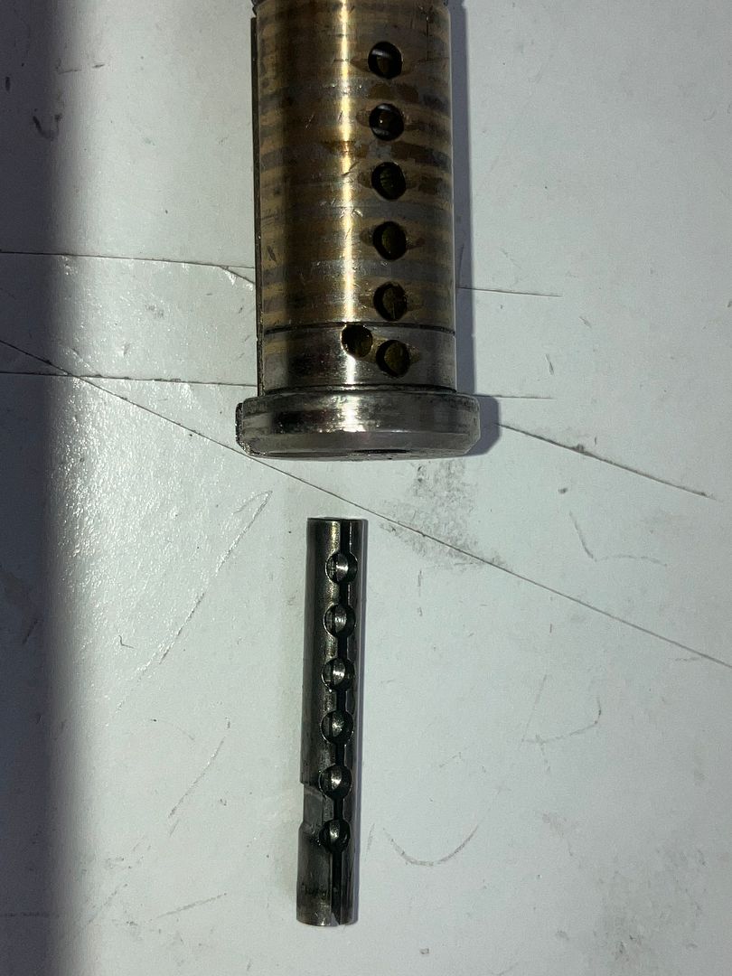

There is a notch on the bottom of the bar, and six holes for capturing the balls. The notch is used to limit travel of the bar, and the pin you (Well, OK... "I") just removed. It keeps the bar from launching out under spring bias and yet allows the bar to be pushed in.
Now that the bar has been removed, you can remove the spring still in the hole.

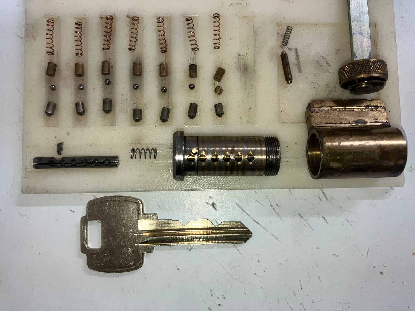

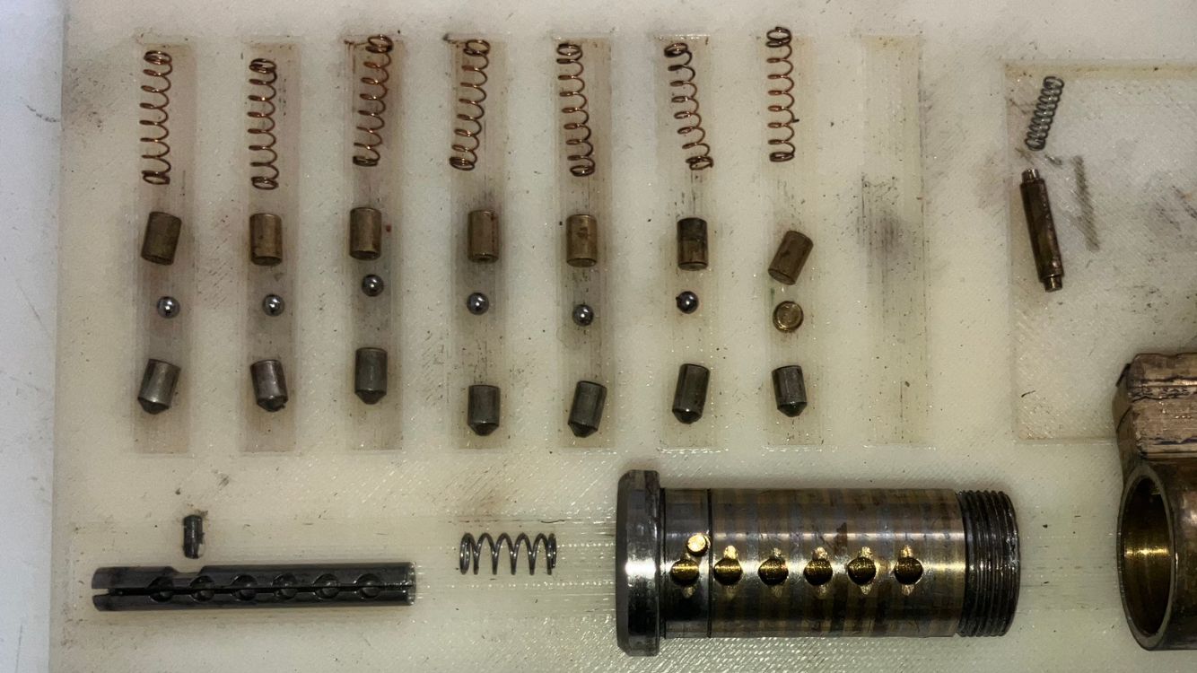

And here are all the parts laid out on the pinning tray Blue60/Anarchy_Won made for me years ago. (Thanks again!)
A closer look...

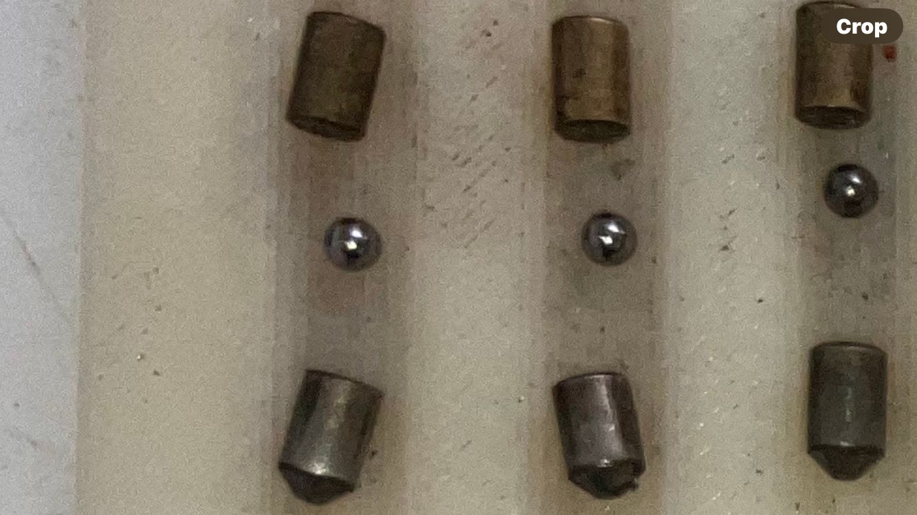

Closer yet so you can see the size of the balls compared to the pins.
So there you have it! This lock functions like a complicated version of construction keying using PK balls as is frequently done on new residential housing in the United States. It is nice that the balls are trapped rather than falling out and onto the table, floor, carpeting or wherever they can find their way when you remove the plug. It is a pain trying to find the ball once it has hit the table and bounced out of sight. (Though they are steel, so a magnet can help).
