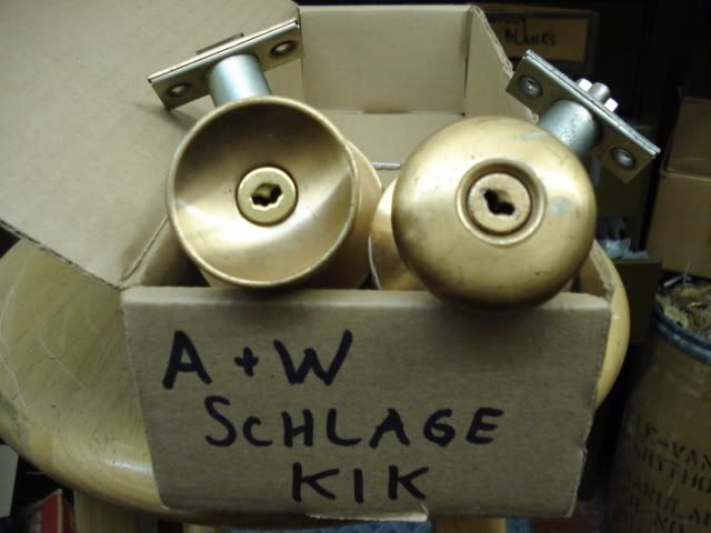

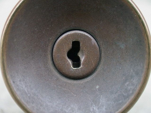

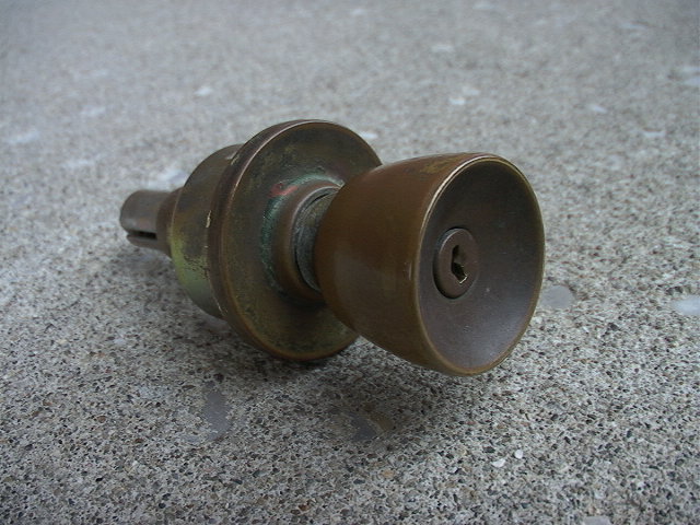

I have this on loan from a friend for a while. It appears to be a wafer lock with every other disk on the opposite side of the keyway. He's still looking for the key but he said it was unusually long. Any ideas?
Just so no one can accuse me of B&E:
I'm told it was aquired in the Las Angelas area. I'm going to have to make a new tension wrench before I can get anywhere, what I have on hand just doesn't do any good on it.

Postby Gordon Airporte » 15 Oct 2006 22:01
Yeah, that'd be a doulbe-sided wafer lock then. Make a wrench to tension it from the center, then pick each side (at least that's how you usually do it - that keyway is so rounded it might not work.) You might have to go back an forth a few time. They usually aren't that much harder than a regular wafer lock.

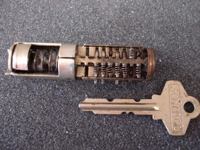

Postby keysman » 15 Oct 2006 22:06
schlage wafer lock.. well made lock.... eazy to pick... double sided key.. wafers on the top and bottom.
This lock uses a binary system of wafers.. either On or off or in this case cut or not cut .. there are no differnt depths of wafer.

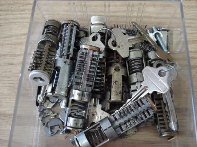

Postby I Pik U » 16 Oct 2006 21:07
They are the older A series locksets, still in use on some older homes in my area.
keysman's explanation is right on. Either a cut or not in each spacing, top or bottom. Also a tip/ward cut, top or bottom. A key having the wrong tip cut will not enter the cylinder all the way.
Some cylinder pics:
