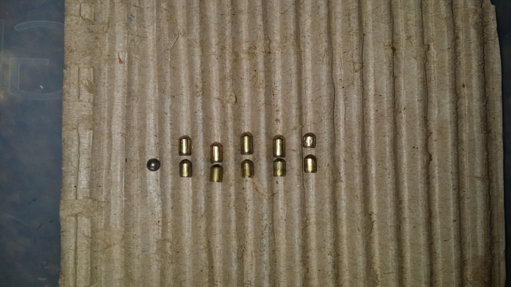

Re: Ball bearing in chamber 6?
Postby GWiens2001 » 21 Feb 2015 7:02
That is an index bearing. It gives a definite feel when the key is in the correct location for removal.
Postby GWiens2001 » 21 Feb 2015 7:51
Idea one: Practice.
Idea two: Practice.
Idea three: Practice.
This is not to be sarcastic. All of us need more practice. My skills have been slipping a fair bit due to increased use of impact tools at work and, most especially, lack of practice. Find myself applying too much tension for too many locks. What do I need most to get my skills back? Practice.
The index bearing may be having an effect on feel - you will need to overcome the resistance of the bearing and related spring when tensioning, but not over-tension the plug.
Postby deolslyfox » 21 Feb 2015 10:13
Some days the lock wins one !! Just like when the stars all align for you and you zip that high security lock in about two passes down the stack, they can align against you !!
If I had to make a guess, I'd say you might have been over-setting that shallow pin ....
I'd put the lock back together with the original pinning and leave the bearing out. See if that changes the "feel" of the pick.
Everybody who picks long enough will run across a lock that they can't open ... At least at that time .... As their skills improve and they gain more experience, they'll go back and open that same lock ....
I always enjoy an experience like you had .... If we didn't want a challenge, we wouldn't be doin' this in the first place ... :D
Remember, you ain't beat 'till you quit !!
