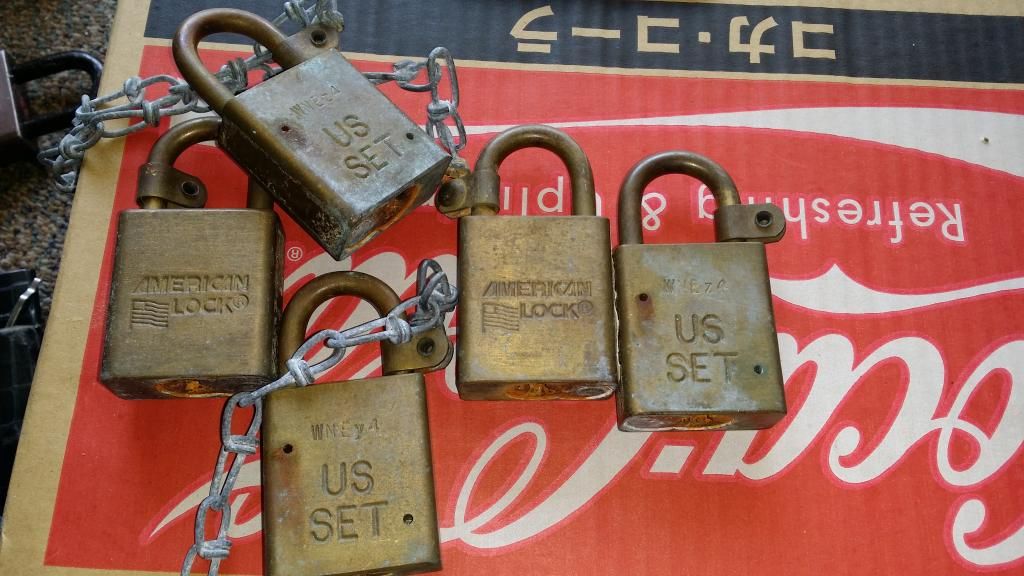

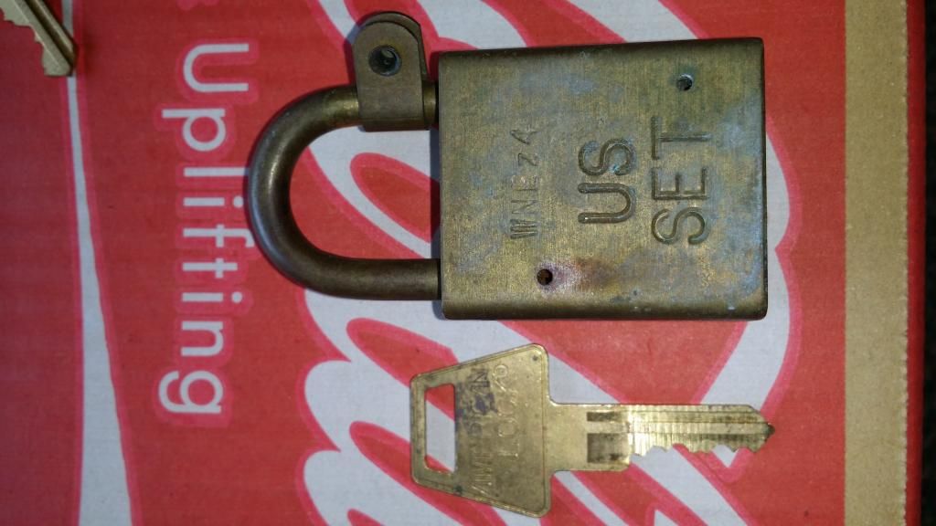

Today I have for you a tough as nails American ASL40N Government solid brass padlock gutted, and with a simple mod.
Here's a couple shots of the lock before surgery.

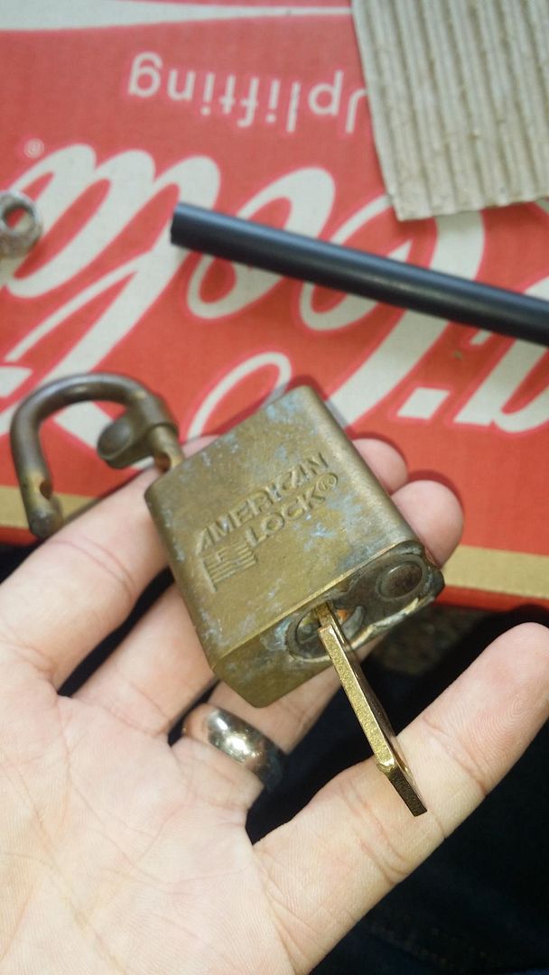

This nasty bottom we're going to do away with, plus the keyway profile.
http://i1383.photobucket.com/albums/ah291/comradehotsauce/20150221_132725_zpswo2dpilf.jpg~original
Bam, key works.
http://i1383.photobucket.com/albums/ah291/comradehotsauce/20150221_132822_zpsuappdvjl.jpg~original

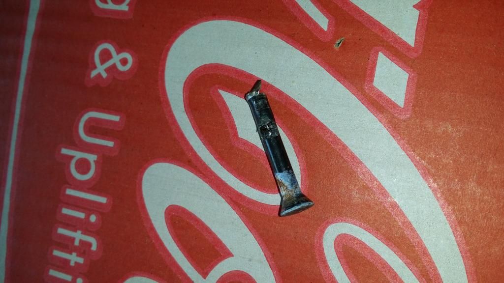

And of course since the lock is non rekeyable, we have not a screw or an allen bit, but a rivet (for now)
http://i1383.photobucket.com/albums/ah291/comradehotsauce/20150221_132835_zpsfo3pqnpo.jpg~original
A quick removal of the rivet. To do so I alternated between drilling and using a tap. After about 5 minutes, it came free.

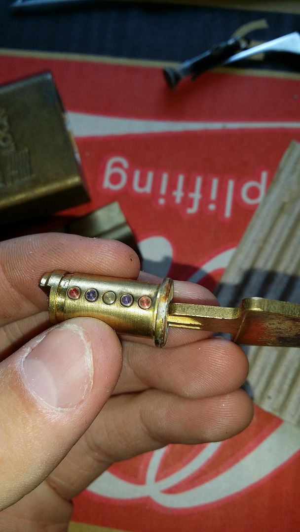

Some guts action. Exactly what I would expect from older American locks.
http://i1383.photobucket.com/albums/ah291/comradehotsauce/20150221_140123_zpsfgtfala1.jpg~original
http://i1383.photobucket.com/albums/ah291/comradehotsauce/20150221_140309_zpsgbcmekta.jpg~original
