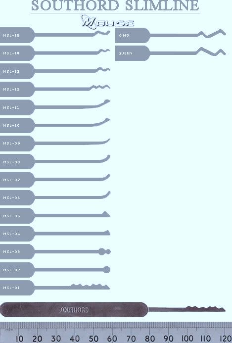

Postby sisk » 9 Aug 2016 13:40
What I know as an offset hybrid is labeled MSL-11 in this image. It's basically a deforest diamond with a half-ball instead of a half-diamond. In fact the other thing I've heard it called is a deforest ball.
I've heard somewhere (I don't recall where) that they're good for a certain type of lock I'm having difficulty with that can't be discussed outside of the forums I can't yet access.

Postby Daltonj21 » 10 Aug 2016 5:46
That's not the "offset hybrid" as I know it. To me the MSL11 I'd a deforest ball.. the offset hybrid from sparrows is a mix between a short hook and a half diamond. "Hybrid". I haven't heard of anyone else calling a pick that.
http://www.sparrowslockpicks.com/product_p/11.htm
Anyway,I'm going to be that guy though. I have both, a bunch of deforest diamonds and a few offset hybrids. I really like both its really comes down to what I pick. If I can get the deforest in the keyway, I'll use it or a gem most of the time. If I'm picking locks with small keyways, its probly going to be the hybrid or a standard hook. That's just me.
