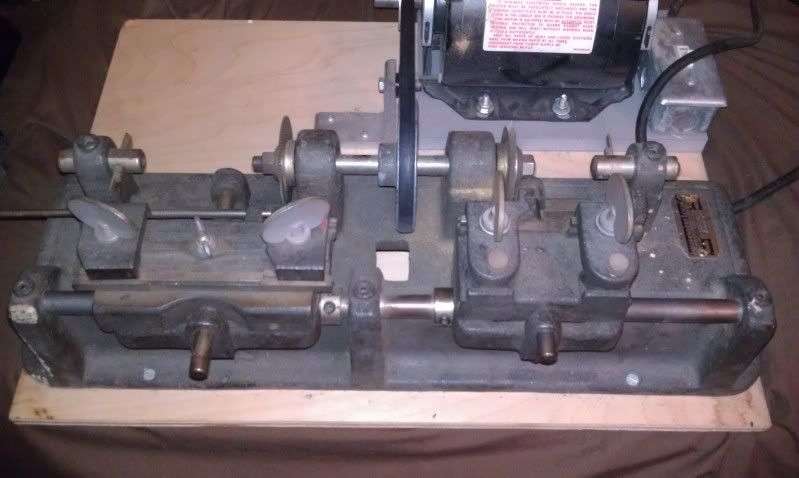

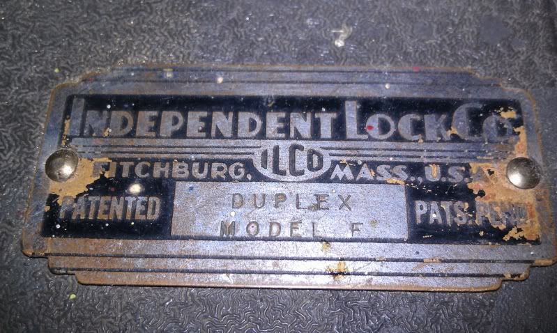

I recently picked up this old ILCO duplex key cutter, seems to be in good working order, and has worked well for the keys I have tried (some regular schlage house keys, and some best door lock keys) from my research, it seems to be pre 1974, but that's about all I've found.
I paid $50 for it, along with 500 or so key blanks, so I'm assuming I did good...
My question is, are the cutters interchangeable with current model ones? I appreciate your time, here are a couple pics.

Postby keysman » 28 Jan 2014 12:47
Nice machine , great price!
Contact Gilray tools .. they have been sharpening/ selling key cutting wheels for decades

Postby snakebyte » 28 Jan 2014 13:47
Thanks for the link...the thing still looks like the wheels are good. Don't really know how to check it, but they still seem to cut good.
I like to have spare parts, just in case.
Any idea what these would normally go for? I grabbed it without even looking it up because it was so cheap, but I had a hard time finding any in that model/style even for sale.

Postby cledry » 20 Feb 2014 18:36
The duplex isn't a popular model, but is certainly worth at least $200 without the blanks.
As for replacement cutters just measure the hole diameter and the outer diameter and match this.

Postby billdeserthills » 24 Mar 2014 20:53
snakebyte wrote:I changed it to unavailable, I'm not trying to step on any toes, or give the wrong idea.
I just don't need two cutters if i'm doing the course...I can only have so much wrapped up in a hobby.
The thin cutter is for steel keys, like safe deposit boxes and old lever tumbler locks use
the cutter tracer has a particular profile, it is best if you buy the cutter that matches the tracer
as well as possible, but you can likely get more cutters. Nice score, I love those older key machines
Other parts are prolly gonna be harder to find, like a new cutter shaft, the bushings can be found at
ENCO (1-800-use-enco) or they may even forward you to MSC, both of these places sell machine shop
tooling and materials.
Far as the "Duplex" not being a popular model, I have 2 duplex machines in my shop, it just depends
on whether you cut steel keys or not. Many times you can cut barrel & bit keys with the steel cutter
blade as well, I know I use my duplex machines for making keys to old padlocks all the time.

Postby billdeserthills » 24 Mar 2014 20:56
I wanted to say, usually if you unscrew the nut and look on the cutter there will be a number there on the side
