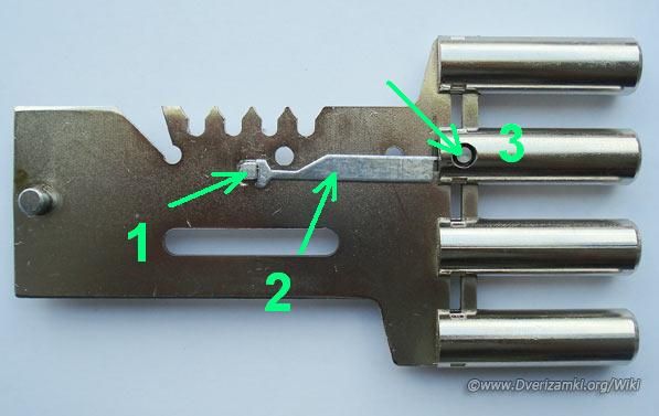

This is Russian Kerberos 308 lever lock. 8 levers. It has installed into the cover drill rsistant plate. Also it has interesting blocker. If somebody try to brake the lock stump than the lock will be deadlocked.
You can see the false notches on the levers.
Bolt plate:
1-Stump
2-Blocker lever
3-Springed blocking bolt

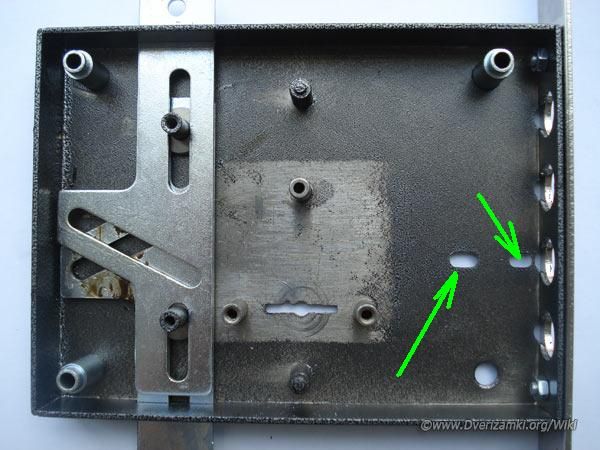

When the stump(1) is broken the blocker lever(1) is released the springed blocking bolt(3). And this bolt enters to engage whith these holes in lock case.
Other side of the blocking bolt chanel.

I like that spring loaded bolt. Do you have much of a problem with the blocker breaking?

GWiens2001 wrote:I like that spring loaded bolt. Do you have much of a problem with the blocker breaking?
Yes, you are right. This is spring loaded bolt.
No,the system is reliable. No false activation of the blocker usually.

I had seen this lock advertised on locks.ru years ago and at that time I thought the blocking mechanism was like a traditional lever lock anti-pressure device i.e. that it would resist picking by being activated by typical picking forces between the stump and the levers. But I thought as it didn't appear to have a reset mechanism it would be vulnerable to vandalism or to serious accidental lock-outs if you tried to use the wrong key.
But now thanks to your photos I see it is only designed to resist forced entry, not non-destructive opening.
Just to confirm, is that correct? You have to actually destroy or deform the stump for it to activate?
Thanks again!
