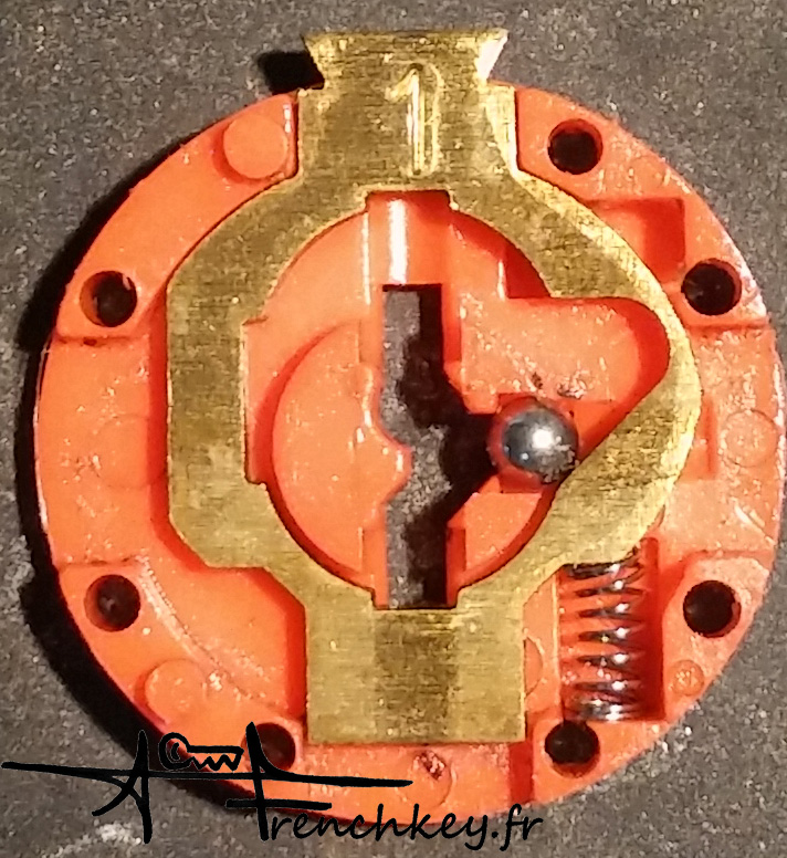

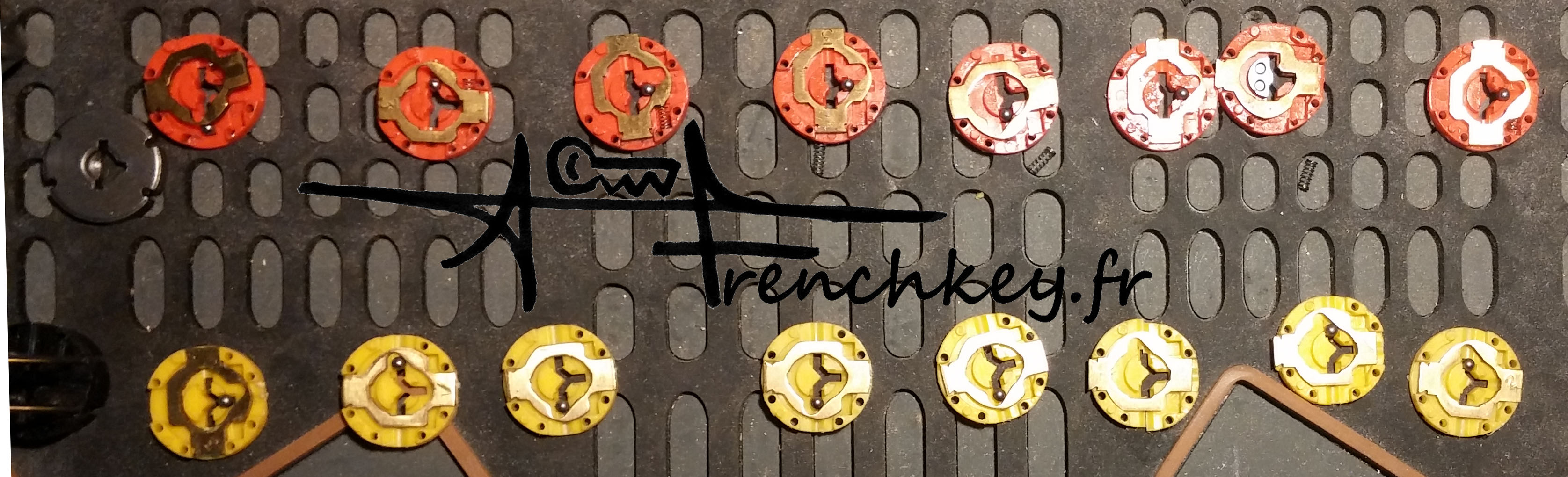

Bricard Supersureté :
It's a "kidda" wafer lockwith a 3 blades key. Wafers are pushed by a ball bearing, which can be on top, right or bottom of keayway.
On the picture, the red parts are from a lock that uses a key with a moving ball bearing in one place (there is no ball in the lock at that place, it's the one just before the end)
The yellow part uses a different keyway and the key has no ball bearing in it (the one place where a ball is missing is just because it's lost during breakdown)
http://frenchkey.fr/s5g7g8f5z1e25fgf5ezef/Autopsie_Bricard_Supersurete_MrJack.jpg
Here is a zoomed view of a slice so you can clearly see what's happening
http://frenchkey.fr/s5g7g8f5z1e25fgf5ezef/Autopsie_Bricard_Supersurete_Zoom_MrJack.jpg

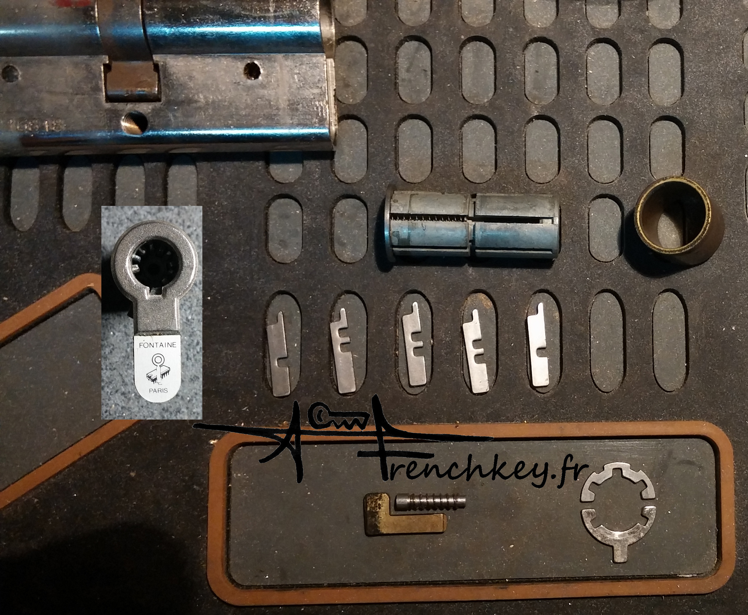

Fontaine 5 pumps
This one is masterkeyed, that's why there can be 2 notches instead of 1. Nothing fancy, works like a Bramah lock basically.
http://frenchkey.fr/s5g7g8f5z1e25fgf5ezef/Autopsie_Fontaine_MrJack.jpg

Here it is. http://www.lockpicking101.com/viewtopic.php?f=9&t=59078&p=435335&hilit=bricard+supersurete#p435335
I had wondered previously if one or two of the Bricard's bittings were redundant, but your pictures explain it nicely. Thanks!
