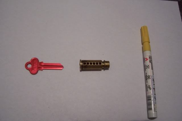

Well i was bored and i decided to make something that resembles a guide to cutting keys to code without a code machine.
I suppose once in our lives as lock pickers we were at a stage when we needed or wanted to learn to cut keys to code – cutting a key to code is cutting the key according to the pin code of the lock. The pin code s generally five to six numbers depending on the make of the lock. A simple key code can look something like this “987473”. This number tells me I need to make the key to work in a lock with these pin sizes.
Pin sizes in most locks are 0-9 or 0-6 depending on the lock, but for this guide we will be using 0-9 to demonstrate.
As we all do not have code machines many decide to do it by hand, with files and key blanks. There are many ways you can do this; one is with depth keys – which have slots for measuring key cuts or using a cylinder for the particular key you are cutting and using pins to determine whether the key has the correct cuts in it.
For us that don’t use or own depth gauges it is easier to use the pin and cylinder method.

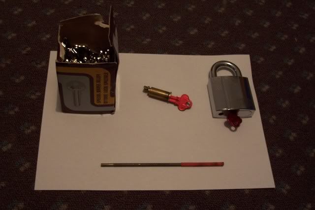

The way we do that is to have the following tools and equipment:
Key blanks
3-4mm chainsaw file
Small flat file
Pins – the pins that make up the code you are cutting the key to
A marker
Lock cylinder of the same make of the lock you are cutting the key to.
Box of key blanks, cylinder, lock and chainsaw file.
Key blank, lock cylinder and marker.
Marking the key

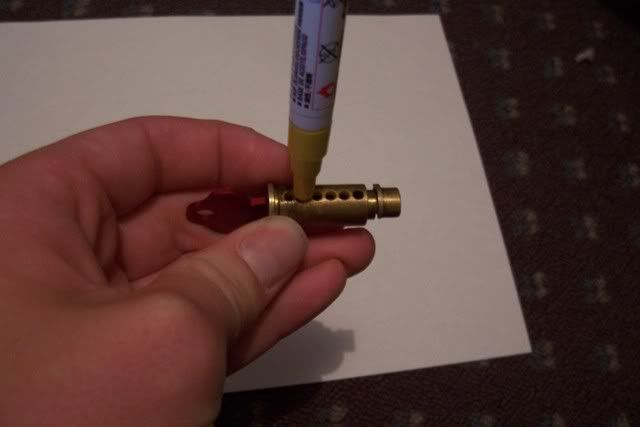

1. Insert the blank fully into the lock cylinder
2. Put the tip of the marker in each hole so that you leave a mark for each cut you are going to mark (it marks the exact spacing so there is no risky guesswork involved)
Cutting the key
1. Start cutting the first mark from the shoulder with the chainsaw file, regularly checking to see how far you have to go before the cut is finished. (this is done by placing the pin that is associated with the first number of the key code in the first hole of the cylinder)
2. Repeat until the code has been cut into your blank.

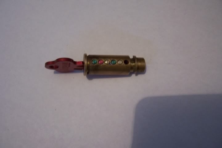

As you can see the cut isn't quite deep enough.
This is what the cylinder should look like once all the cuts have been made into the correct depth. The pins should sit flush with the top of the cylinder.

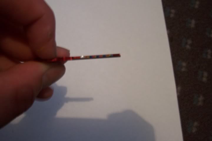

1. Before putting the key into the lock it needs to be made useable, you will notice the points are jagged and are cylinder shaped (this means if the key is inserted into a working lock the pins will set into the cylinder cuts and trap the key) You will need to use the small flat file to file the jagged parts down to a useable height.

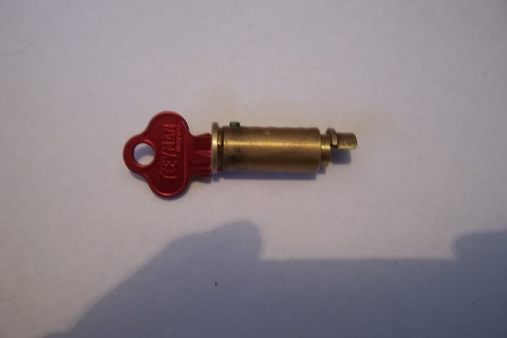

2. Once this is done and there appears to be no risk of the key being trapped, insert the key into the lock and test to see if it works.
Finished product.

Can't fault the method there :) except for the following day when you get another code for another lock to do, you'll have to repeat the whole process again.
Humble sugguestion here, seeing as you have a spare core and pins, would'nt it have been more prudent to have cut depth and spacer keys for easy future use? It's what I do whenever I come across a lock I dont have a card on my Blitzâ„¢ for.
Might also be worth noting that the same principle also applies for wafer locks, 1 and 2 sided as well as most laser keyed locks.

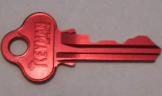

That was a nice post, I enjoyed the concept of using the cylinder (and sized pins) to position the cuts. :D Just an observation though. The cuts on your key are flat, whereas a key from a lock manufacturer would tend to rise each side of the pin positions. I assume this is to help the key to position itself positively, so it is obvious when you haven't put it in the lock the right amount.
Of course the key will work fine in the lock, and the flat cuts are much easier to do accurately. But for a bump key you couldn't just file it flat!
As I say, it's just an observation, and in no way a critisism of the excellent post.
(Actually it reminds me of the first cylinder key I filed a copy of, many years ago. There were 2 cuts the same height and then 3 cuts the same height as each other, so the key had just 2 levels, and looked nothing like the original, even though it worked fine.)

Postby Dimmy Locks » 23 Oct 2005 6:06
I often cut pin lock keys using a flat tipped cutting blade which is actually designed for wafer locks. The reason being, many older pin locks I come across as a vehicle locksmith have dented or damaged face plates and shoulder stop plates. By having a flat and not perfect "V" to the trough of the key allows for and missalignment due to these imperfections. I also often will actually cut the keys right down to each pin level across the blank.. I.E. assume we have a 5 depth gauge and 6 cut spacing to the lock. the code being 34453. I would cut the key down to depth 3 RIGHT ACROSS the blank. ( 3 depth being the heighest part of key required). I would then flatten off positions 2,3 and 4 down to depth 4 ( the next depth). Finally I would deepen cut 4 down to depth 5.
The overall effect is to have "steps" in the key rather than sharp points. naturally the sides of each depth are angled so as to allow the pins to rise and fall smoothly as the key is pushed in and out.
I have found this method extremely useful for older/ damaged locks.
N.B. having a flat contact surface for the pin also helps with impressioning as its clearer to see any marks made by pins.

Postby Chrispy » 23 Oct 2005 6:14
Using the right blank with an untouched shoulder will take care of it.

Postby Sesame » 7 Oct 2006 20:48
The pins need a ramped surface to ride up as the key is moved in and out of the lock. No ramp, the pin just binds and the key won't come out.
