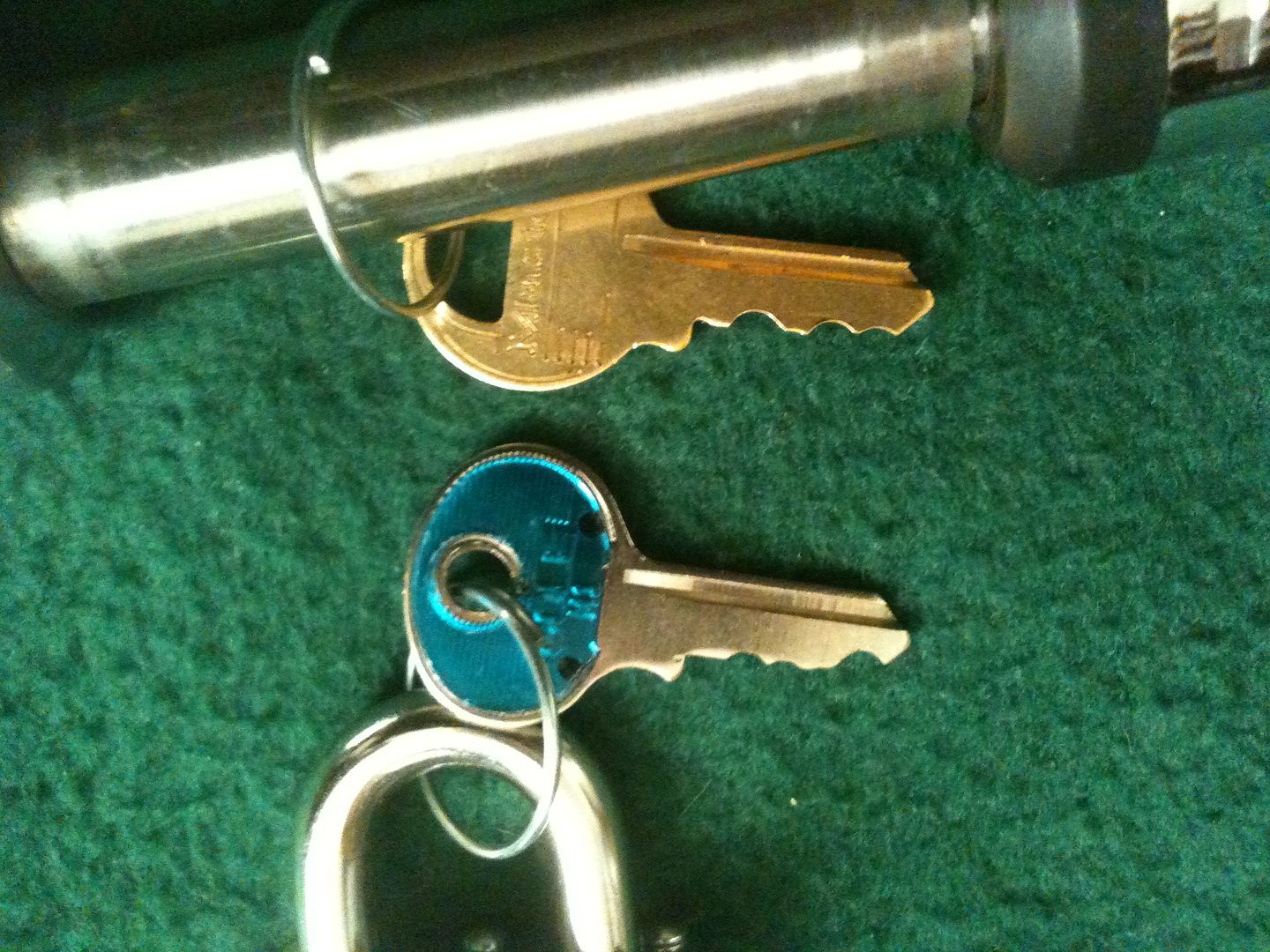

Personally do not try to make the bottoms completely flat. Most of my impressioned keys are round bottomed, but a little wider than the round edge of a file. You can make them flat with a flat needle file or with the flat side of the tip section of a pippin file, then make the angles in the same manner. It is tricky, and takes practice. Another member here, Oldfast, makes keys that look like they are machine cut, though he will tell you that it takes him a LONG time to do so.
The "V" cuts can be a little tricky, as if you make the angles too steep, you will trap the key in the lock. Some locks need a wider angle, and some, like a Wilson Bohannan, can handle a very steep angle without missing a beat.

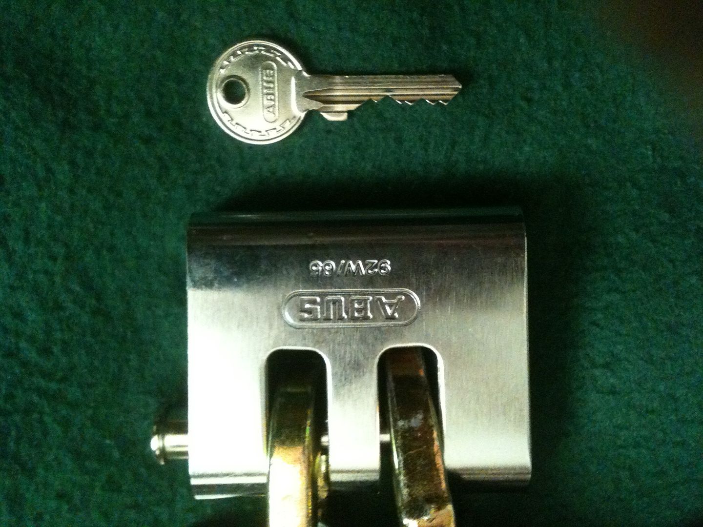

I rarely make keys with a "V" cut, and had a specific reason in mind when I made the one in the pictures above. But some locks, such as many of the ABUS padlocks, are factory made with keys cut in a "V". Here is one of them:
While here are a couple of impressioned keys for Master locks (#3 and a trailer hitch lock). You can see that the valleys of these two are round.
