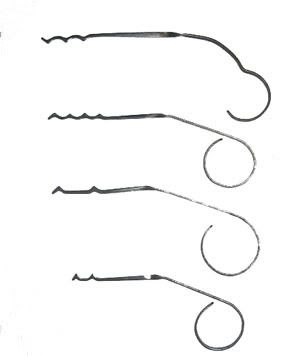

Postby Chucklz » 29 Apr 2007 22:47
The Sabana is another of raimundo's creations. It continues the naming trend of the Bogota pick.
If the bogota is ^^^
The sabana is ^--^
ASCII art doesn't do it justice, but if you own a bogota, you will see what I mean. I will try to dig up a picture tomorrow.

Postby Chucklz » 1 May 2007 18:57
Here you go.
Sabanas are the bottom two, with to Bogota's for a comparison.

Postby Eyes_Only » 1 May 2007 20:39
Rai should seriously consider getting a patent for the tools he makes before some locksmith tool manufacturer steals the designs and markets them and takes all the credit.
Postby Chucklz » 1 May 2007 20:59
A tool manufacturer would only stamp them out and not bother with the correct finish, let alone the handles. And, without the finish and handles, much is lost. Sure they will still be effective, but not as wickedly and beautifully effective.

Postby dmux » 1 May 2007 21:02
sanding and polishing is the key to all picks i think after using the bogotas, it makes a huge difference if they are nice and glassy smooth or punched out at the rate of 10 picks a second through the same die with no deburring
