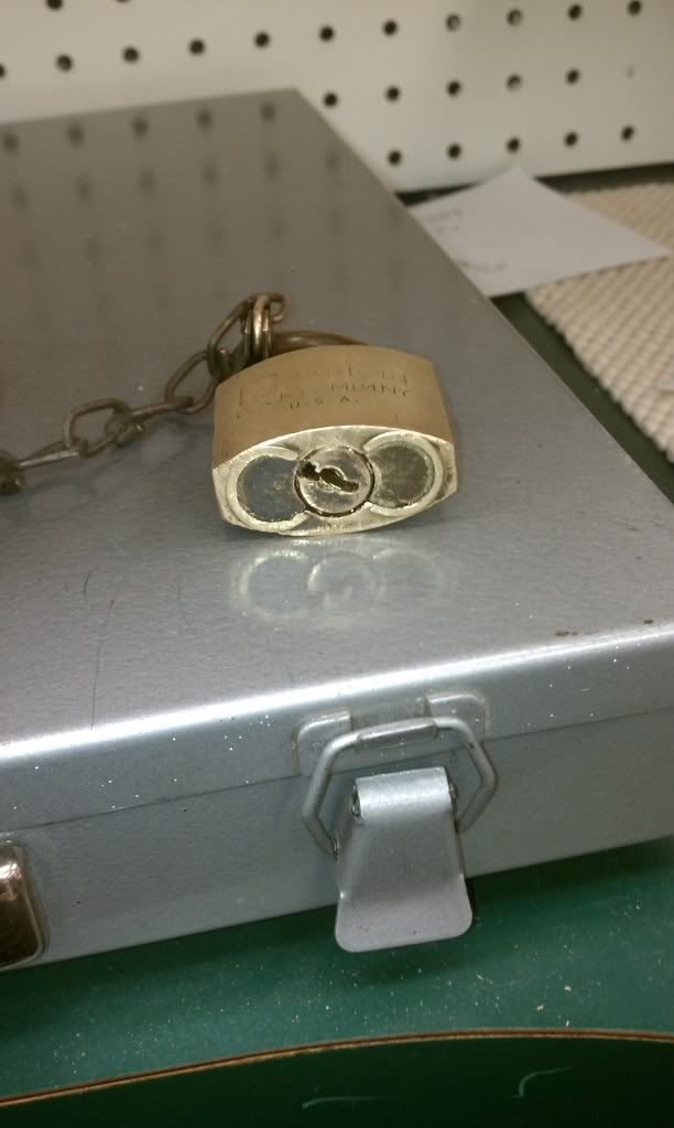

I have got a American Lock that is a pain to pick but once I get it picked how do I get the core out of it. The story behind this lock is a buddy of mine brought it to me and the lock use to be him dads, but he didn't have a key for it. It seems like it has a removable core but I can't figure how it comes out or what you have to do to get it out. Please help.

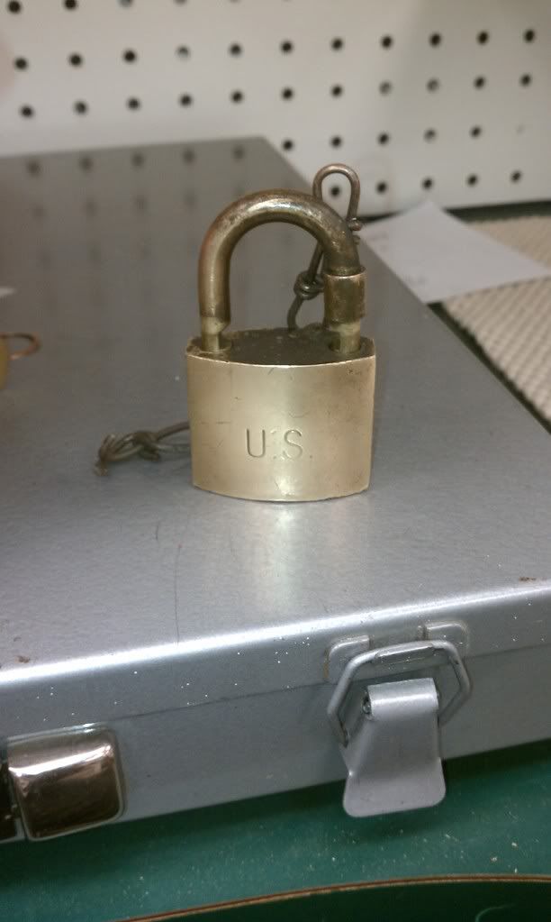

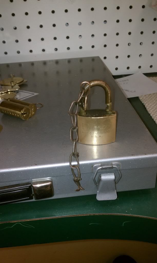

Postby tjfrazr » 2 Nov 2011 11:11
No screw that is the first thing I looked for, but here are a few pics.

Re: American Military lock?
Postby femurat » 2 Nov 2011 11:18
I've never seen a lock like that, it looks very old. Maybe some member from the other side of the pond can help you now that you've posted some pictures...

Postby averagejoe » 2 Nov 2011 16:54
I do not believe that you can take those apart without destroying them. They are crimped on the bottom. no screws to take out.
Postby Raymond » 5 Nov 2011 20:42
This lock was never intended to be taken apart. On the bottom of the lock, the brass is crimped over the spring-top-pin part of the cylinder. This crimping can be knocked loose by steadily tapping the cylinder out with a shackle width punch through the shackle hole. You can also try tapping the shackle inward and it might knock the cylinder out. If you can get it out without deforming the back of the cylinder, it can be placed back into the lock easily and the bottom peened over again. With the cylinder out rekeying is easy.
