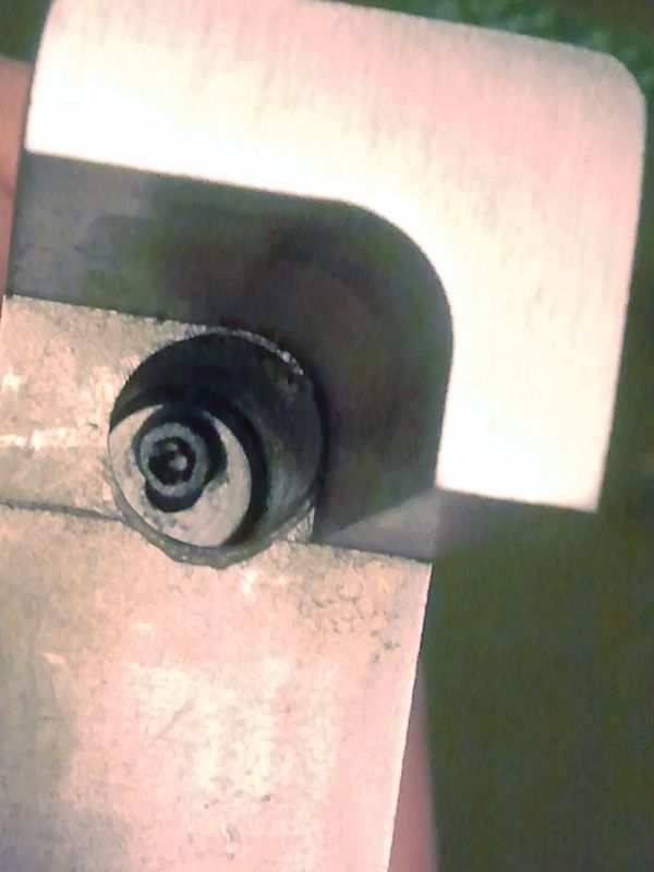

If you look into the hole where the toe of the shackle goes, there is an allen-head screw. You may need to clean out the garbage buildup before you can get to the screw.

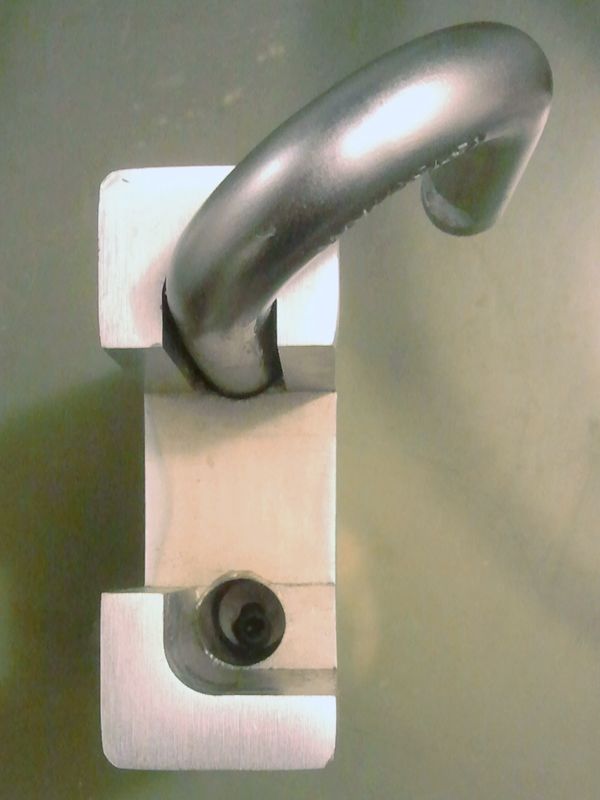

I cleaned it out well, Here is a picture. That's what I originally thought most all are like that.

Okay I cleaned out all the crap from the Allen screw from the back of the lock. It really didn't look like one. I removed it, and the shackle still doesn't seem to want to budge. I'm not sure if there is a pin behind the Allen screw that is suppose to fall out releasing the shackle. I will keep trying... :evil:

Hello Sublimis, sorry I'm late. There are two things that prevent the plate from sliding out: the allen screw and the shackle itself. It slides out on the side.
The allen screw requires a 3.5 mm allen wrench since my 3 mm rotates freely and my 4 mm doesn't enter and unfortunately I only have that set handy now. The screw is located in the hole left empty by the opened shorter side of the shackle, and is a little off center.

Cool, Thanks for the reply. I took the allen screw out and the shackle still stays in place... Is there a pin that is behind the allen screw? This lock is old and all rusted up... at this point I want it apart! :evil: lol Here are the pictures.

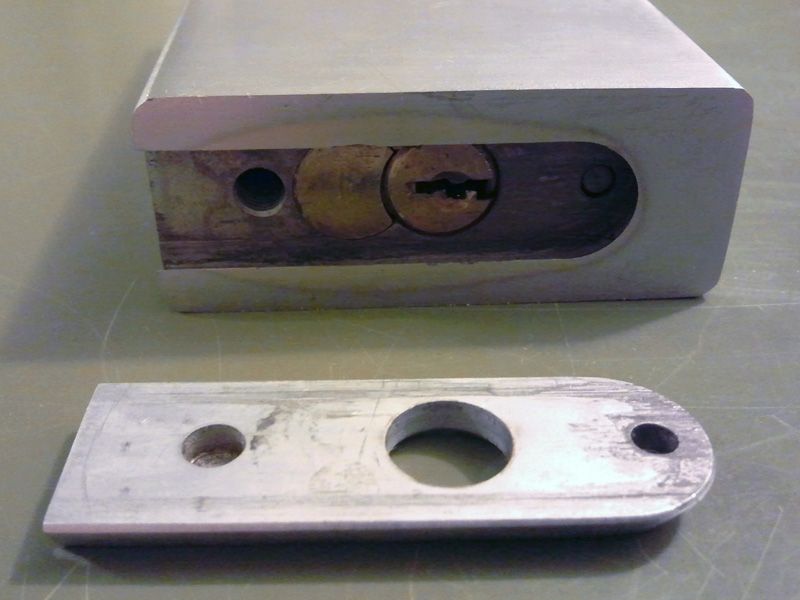

Anyway, this is the bottom plate removed. You can see on the left the threaded hole where the allen screw normally is, and on the right the pin that automatically goes up when you open the shackle and down when you close it
and this is the hole where mine has the allen screw I had to loose in order to remove the bottom plate

There is no screw on the inside of the shackle. This thing has to come apart, when the lock is unlocked the plate on the bottom isn't under tension anymore and is not stuck (doesn't move much but it does move)
Here is the image of inside the shackle...

Okay This is How it's Done!
1.) Cuss out the padlock
2.) Flip off the padlock
3.) Remove the Allen screw from the back of the lock (3/32")
4.) Make sure the padlock is locked pore Marvel Mystery Oil in the hole where the Allen screw was
5.) Grab a 2lb rubber mallet (the bigger the better)
6.) Beat the living crap out of the padlock to remove the shackle retaining pin
7.) Remove the shackle and spring
8.) Remove the shackle heal ball bearing.
9.) Grab a magnet (pen or needle type)
10.) Insert the magnet in the heal shackle hole.
11.) Pull out the bottom plate keeper pin
12.) Slide out the bottom access plate
13.) Remove the lock assembly core
14.) Remove the actuator
15.) Remove the toe ball barring
16.) Flip the lock off again and tell it "What's up now Mother F$#Ker!" :twisted:
Note: The bottom access plate and lock core are in the reverse order in the picture...
