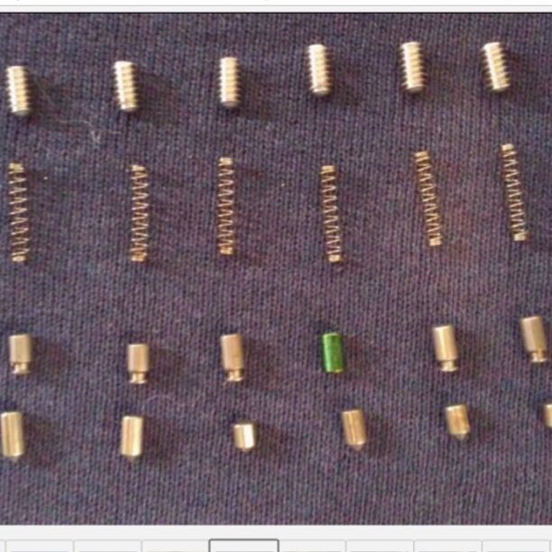

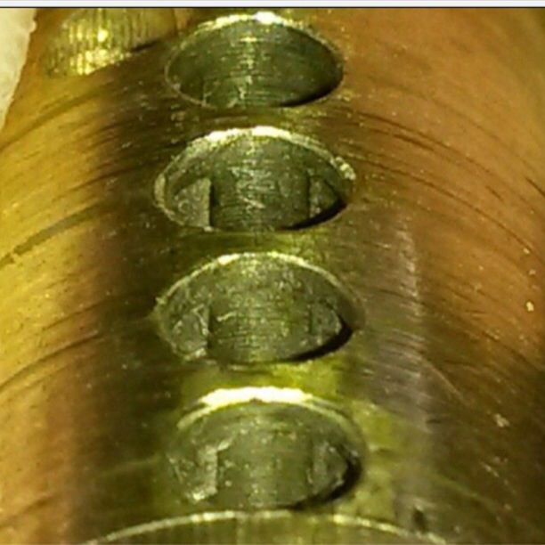

It sounds like it has a sleeved core. If you get it shimmed, could you gut it and show the insides? If it has a sleeved core with out of round holes, picking will be almost impossible.

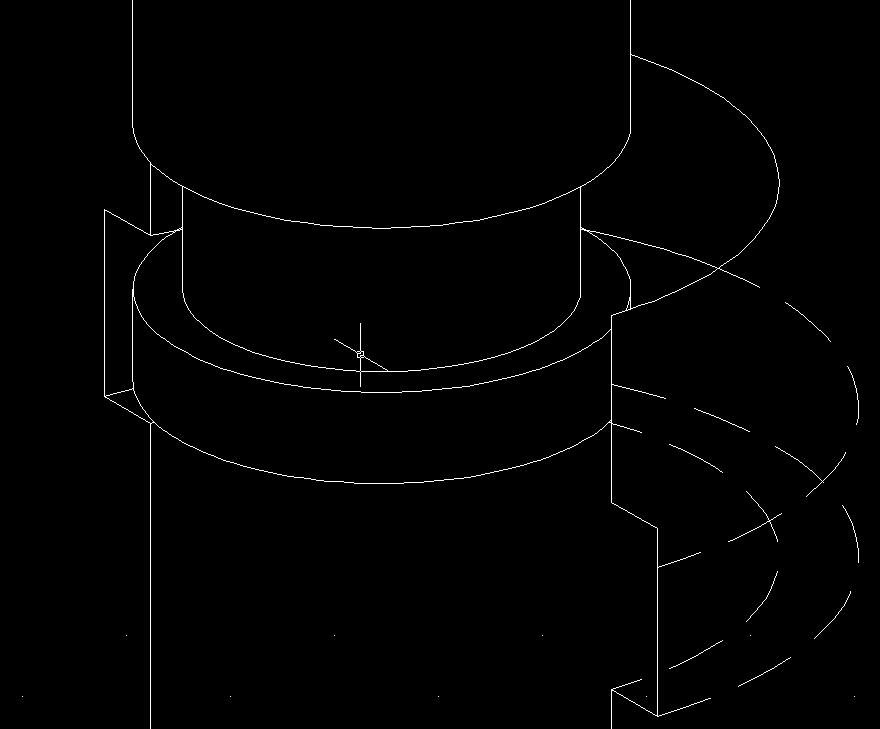

Here are some sketches I done long ago for the forums to explain how the assa pins work and interfere with picking. Practice goes a long way but to be honest plug material (ss or brass) along with plug wear make the most difference for me.
http://img.photobucket.com/albums/v375/ ... a494aa.jpg
http://img.photobucket.com/albums/v375/ ... 98c7e4.jpg
http://img.photobucket.com/albums/v375/ ... d723d3.jpg

Based on how much the core turns when I hit false set and the fact that it feels seized up to the point that it stays there with zero tension. I believe this is what I am dealing with.
At times I felt like I am one pin away from open but rotating the core back to set it would undo everything. I've seen a few people pick these in the "what did you pick today". I would greatly appreciate any feedback from you guys. The only thing I haven't tried is a long hook and I plan on giving that a try on the weekend.

The 3 times I have picked that cylinder, I got to the deep set. Then nothing. I had to ease up on the tension. Lost a set or maybe 2 but set another one. I find that the easy to reach deep set is NOT the first pins that need to be set first. Took me over an hour my first time. Had to tie off the pry bar with a rubber band to hold the set and rest my hands. The fastest time I picked it was just over half an hour. It is even harder using the new ASSA double end spools. Could psychological because you would think the old christmas tree spools would catch the counter milling in the plug better.
