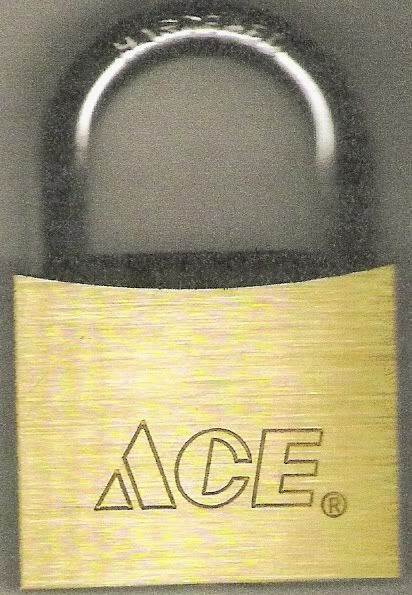

Postby tmaxx258 » 24 Jul 2007 20:03
Well i decided to buy this lock today.It has spool pins in it so i thought a challange to pick.So i have a problem i put my tension wrench in and apply light-medium tension,I put my short hook pick in and start from back to front and i let go of the tension and i only hear 1-2 clicks witch frusterates me. Can somebody tell me what i am doing wrong?
