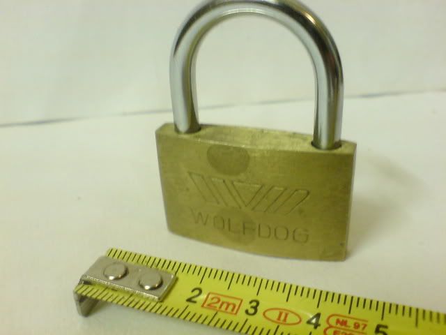

Tere are some photos:
Here are my locks with names. I think it's pretty cheap locks, so I don't think there're a high-security pins.
http://www.imageup.ru/img6/locks-00376479.jpg
There are the keyholes.
http://www.imageup.ru/img6/locks-00476480.jpg
There are a keys, that fits in some of locks.
http://www.imageup.ru/img6/locks-00876484.jpg

Postby Olson Burry » 19 Dec 2008 17:08
Its wolfdog!
I have a wolfdog, he's a bit worse for wear actually but nevermind.
You'll be out of luck finding blanks for most of those I should think,
let alone new cores.
Get super quick at picking them perhaps so you can do it faster than with a key anyway?

The keyways appear to be Yale 999 variants, just as abus uses, the key blanks shouldn't be hard to find, then you can cut a knife edge on the top of the blanks, and bind right bump up, bind left bump up bind right bump down bind left, bump down, etc The impressioning drill, you'll find threads on it here.
I cheat when impressioning, I pick the lock and while the cylinder is turned, I feel for the deep and shallow pins, Then I can be careful not to over cut the shallow ones and I can swag cut the deep ones a bit, (swag= scientific wildass guess) This moves the process along more quickly
Always come prepared to break a few blanks when impressioning, even if your so good you seldom need to, you want to have them just in case. In impressioning, a broken blank shouldn't stop you.
