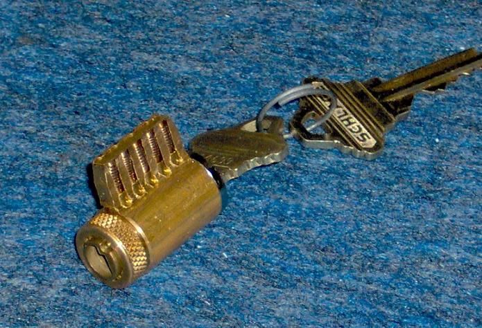

So I managed to get a hold of a few different Schlage cylinders (I believe they were removed from deadbolts--got them off eBay) and I thought to myself, "Self, it would be nice to make a cut-away cylinder out of one of these."
So I did.
Here the key is inserted and the plug is turned, so all the driver pins are lined up:

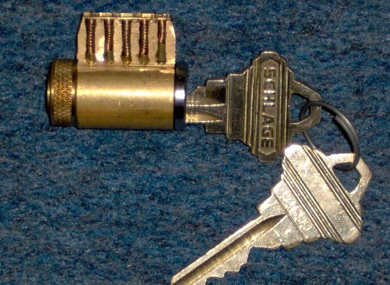

Here's a straight-on shot when the key isn't completely insterted:

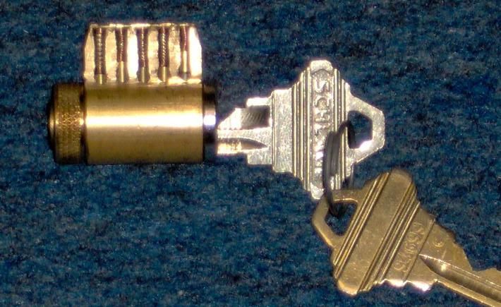

And another (forgive the glare):
So, what do you think? I like the idea of a cut-away Schlage because it's a better-quality lock than most cut-aways for sale out there. I'm hoping it'll give me a better feel of what's going on inside the lock when I'm trying other picking styles. Now I just need a way to mount it.

Postby kodierer » 22 Mar 2005 18:41
Pretty cool
What did you use on it? A dremel?

Postby Kayvon » 22 Mar 2005 18:45
kodierer wrote:What did you use on it? A dremel?
Yes. And a grinder, a pocket knife (smooth off shavings), a tubular knife (smooth inside where the grinder had prevented driver pins from moving), a sander, a dental pick (to replace the springs/drivers), and probably a couple other things that don't come to mind right now.
