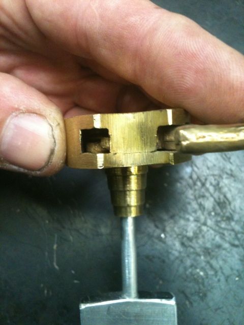

Making a key for my Ministry Of Works (M.O.W.) lock. It took a bit of figuring out, but it works!

The resulting key and lock!

Postby Squelchtone » 1 Jul 2013 17:57
I'm lost. Can you explain how the swiveling bit comes out of the key once you insert the key all the way into the lock? and how does it retract back into the key blade once you are ready to remove the key from the lock?
Thanks,
Posts: 11340
Re: Home Made Key for M.O.W. Padlock
Postby GWiens2001 » 1 Jul 2013 18:49
Squelchtone wrote:I'm lost. Can you explain how the swiveling bit comes out of the key once you insert the key all the way into the lock? and how does it retract back into the key blade once you are ready to remove the key from the lock?
Thanks,
Good questions. The swiveling part opens by gravity, and falls out the bottom of the key into a taller slot at the bottom of the keyway. The narrower neck on the swiveling part allows the key to be turned in the thinner slot which goes all the way around the keyway.
Once the lock is removed, turn the key so the swiveling arm is at the bottom of the keyway again, and flip the key/lock so that the key is pointing straight up. Gravity then pulls the arm back into the key shaft, allowing the key to be removed.
The lock is not key retaining, nor does it require the key for relocking.
Now it can be seen why I emphasized the need for that arm to pivot freely. If it binds in the lock, there are problems.
Here is a picture down where the shackle locks. The brass lever/locking dog is angled, and also attached to the other side of the shackle. As you close the shackle, you can see that lever retracting until the moment the shackle is fully closed, when it releases and locks with a stout SNAP. The spring is surprisingly strong.
