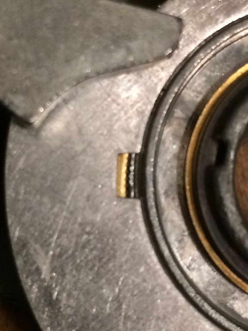

The other way is to line up the indexes in the change key holes in the wheels with the screw holding the lock body onto the safe. You can see the index on opposite sides of the change key hole. This is something that it is important to check. When the wheel is locked (Ready for normal usage of the lock), the index should be like this:
When the wheel is unlocked (ready for the combination to be changed), the index will be aligned parallel to the outer edge of the wheel.
A somewhat common problem is when one or more of those change indexes are out of phase with the others. Perhaps two are locked and one is unlocked. A symptom of that would be the lock not functioning, and the combination seems to change itself. So be sure to check that all of them are aligned like this before using the lock…
Waaay in the lock, you can see the torque adjuster. Will cover that later.
Another visual way of confirming whether the change key hole is turned correctly is to look at the next hole on either side. Here, you can see a thin gap between the brass part inside and the inside edge of the hole. This is locked (ready for use).
And when there is no gap, the wheel is unlocked (ready for combination to be changed).
